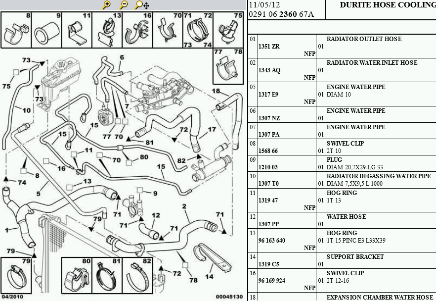

Hello all,seasons greetings! Once again the French have me baffled,a very slow leak of coolant has been going on for months. My good mechanic located it,I pointed out how evaporating coolant was coming out from behind the longest part of the plastic air intake tube behind the engine.With a torch I spotted the drip myself but this time it's a mystery car part. It is not in the manual and won't appear on any web search under French name "bloc rechauffer".It has four leads coming out the top that look a bit like heater plugs and a coolant hose either side. ..not miles away from the matrix leads.it is a small alluminium type block and the drip is from below,not the hoses or leads on top (possibly electrical). I beg you all for the English name of this part!my mechanic has never had to change one before,I'm just extremely lucky. Cheers guys

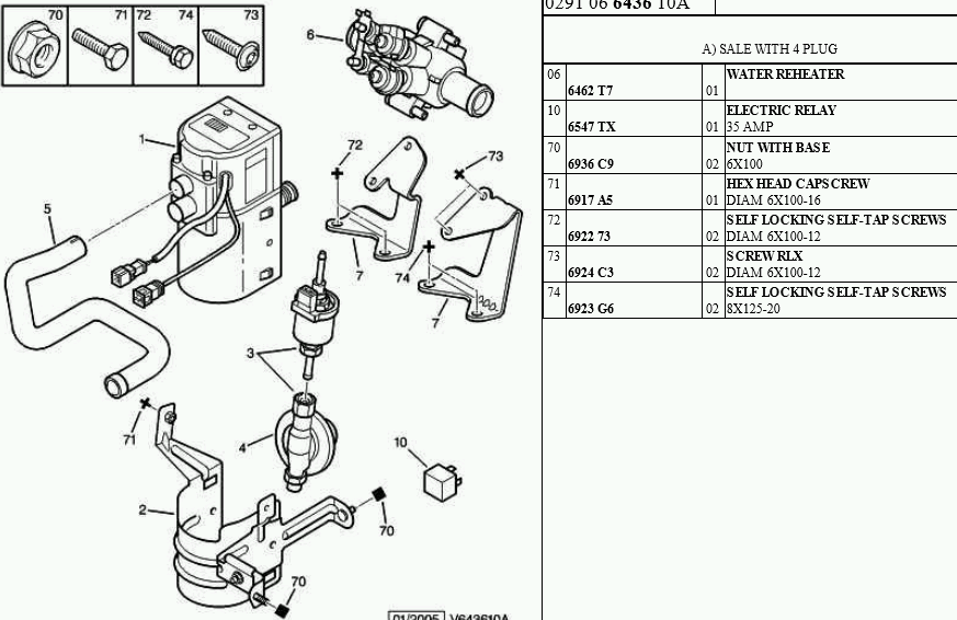

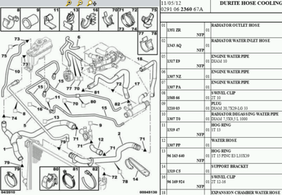

I'll post up what I thing the right Diagram is and perhaps Jim or yourself can confirm if I've got the right diagram:
Cooling System
Water Reheating

I'm not even sure if I've got the right diagram - a bit hard from the OPs description Chris - but hopefully somebody in the Xantia 'know' will be able to work out if the part is there - or not! :-D

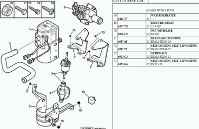

No 6 in the 2nd diagram is the re heater
http://service.citroen.com/docapv/affic ... efaff=0291 06 642607&idFct=FCT0346
If my link works you can see the hoses 1.from engine to re heater 2. to matrix and then to plastic pipe on the bottom to the back of engine block (PIA to remove and get to)

Marc, the diagram you posted is for the later HDi with the Erberspacher diesel powered auxiliary heater... had one of those.. Great fun!

Fabulous findings from all you chaps! I confirm also it's the second diagram part number 6. Should be extremely useful when I ring Citroen parts in Diss tomorrow. Interestingly...it was my mechanic who did the last coolant change BUT he did that for free while doing can belt. Nobodies perfect and sounds like an easy mistake.That said he better get it right this time! Looks like changing the bit is possible if you get the plastic air intake right out. Thanks to you all,bloody good chaps.
