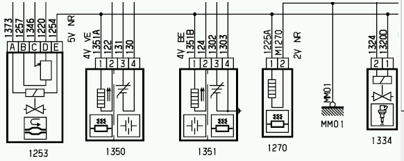

Magneti Marelli multipoint Injection System 48pdeian9 wrote:Hi,
How hard would it be to get the downstream oxygen sensor out? I can see it clearly, but will it be pretty much welded on after all this time?
Does anyone have some electrical characteristics or pin out for it so I can test it? It's outer sheath is frayed where it clips into a rubber gromet holder, but the wires themselves 'look' undamaged.
Funny thing about the injector 2 fault, as it's clearly injector 1 that I can't hear clicking, injector 2 clicks away fine (unless when that one fails, it goes to running on two cylinders). Are they somehow daisy chained and there's a break at injector 2 which leaves injector 1 open hence not working? Are they earthed by the body of the injector or by the one of the two wires?
Thanks
EW10J4 Engine
Downstream Oxygen Sensor for this engine Bosch Ref: OZA 341-PG7 (6-way black connector)
Any other info needed? (I'll dig out the wiring for this sensor in a tick).

downstream is from the exhaust manifold into the cat right, i have four wires going into a blue plug near the egr valve?
- x 6948
Re: Misfire and stuff on 04 C5 2.0i (not hpi)
1303 is your signal from Lambda sensor C (-) downstream of the Cat.
1302 is your signal from Lambda sensor C (+) downstream of the Cat.
124 is the control heating Lambda sensor C downstream of the Cat.
1351B is the Lambda sensor heating power supply.
This should be a 4 pin Green connector (although the info in my last post says 6 way black) - so you'll know which is right!
- x 6948
5 Pin Black connector:
1253 is your all or nothing solenoid valve (EGR)
1254: EGR Supply
1220: throttle potentiometer Supply 5V
1346: EGR Repeat sensor signal
1257: EGR Solenoid valve Earth
1373: Linear EGR control valve
1254: EGR Supply
