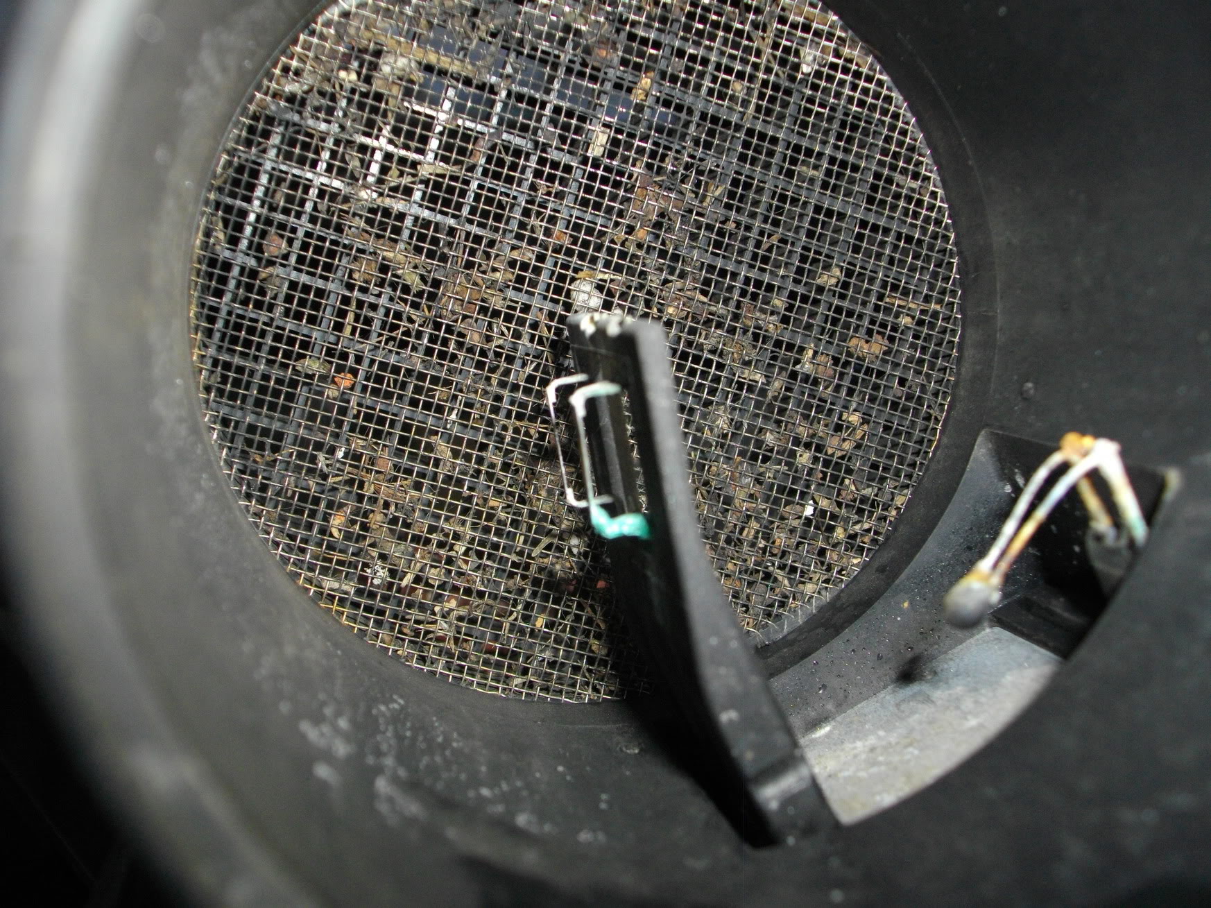

check your MAF sensor.
I had this issue. IT was like a brief missfire jump at 1800-2000rpm.
unplugged maf and it went away but car wouldnt rev past 4000rpm in use(not that i normally use that range but with a dw8 its sometimes required)
Swapped it out and the jump at 1800-2000 rpm was gone and it reved up to 4600 again - even if the limited power stops at 4100

just checked air filter fuel filter housing all look ok.. sprayed some brake cleaner in the egr.. still jumpy so ive unplugged what i think is the maf and seems to run fine.. will hit redline and still pulls fine only issue is eml haha.. would anyone know the price/where to get a new one

Ebay probably best bet. Avoid ones that are a bit um "too cheap" as they won't last very long.
as you plan to replace it you could clean it up (off the car) with some brake cleaner aerosol. Note: Ensure its *fully* dried before fitting it back. Not a lot lose by trying this if its otherwise going in the bin.
New ones from main dealer silly monies unfortunately.

If you replace it do try and get a genuine Siemens/VDO unit, the cheap ones don't last.
I have bought 3 - 2 for the first of my C5s -ruined it with water and grit sucked up when the wheel arch liner disintegrated.
When the current one began to fail I bought a spray can of carburettor cleaner and drowned it in that and a year and a half later it is still fine (fingers crossed)
Don't drop it under any circumstances and don't touch the two fine wires with anything other than the spray.
They are very delicate.

There's a 6 digit number on the underside of the maf body.
Search for that. There is a website that just does sensors. Cant mind it off my head but that's where I got mine. Can't mind the websites name now but the same maf is on many cars and propper pug ones are about twice the price
