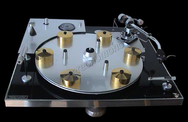

How is the platter suspended?
Once transported a brand new Transcriptor (as seen in "Clockwork Orange")on the back seat of a Volvo, from Borås to Västerås.
The platter and tone arm are suspended in wells of oil, some of which leaked out..
Took years to get it to spin at the right speed again.
Incidentally, Transcriptor was born at Michell Engineering, attached to the Vickers-Armstrong tank factory on Scotswood Road.
