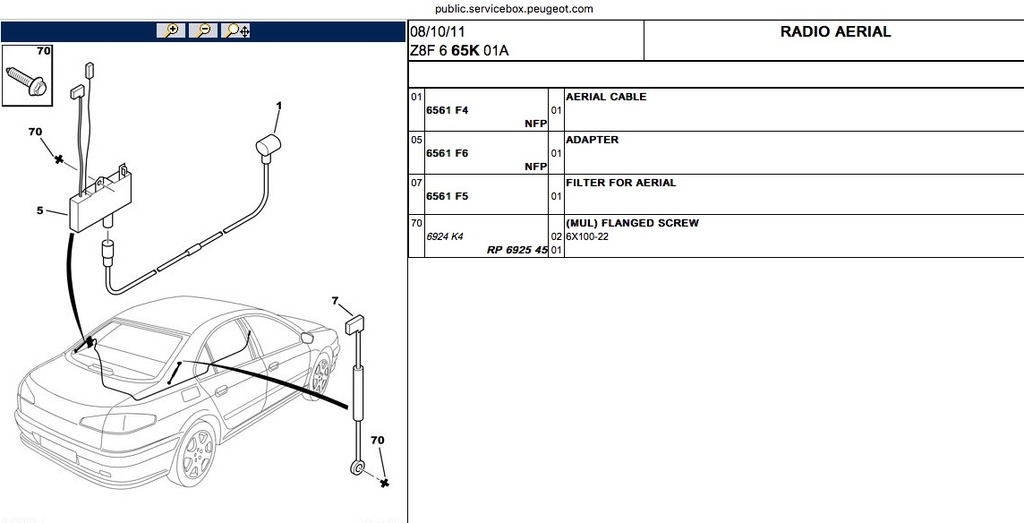

I had a look on servicebox mainly because i could not see an aerial on the car. Seems to confirm the theory that the rear window heater is used as part of the aeriel:
Something to take a look at nonetheless and see if there is any corrosion or damage to these parts.

I take it from that parts diagram the radio is using the HRW as an aerial.
This used to be done back in the 70s, and caused problems then (a) if the HRW wasn't properly grounded (although a grounded aerial is an interesting idea!), or (b) if the HRW was switched on. It was also prone to interference from IGN and other sources. The whole idea went out of favour for a while.
The modules above will be aerial signal amplifers, and filters to block out the d.c. and grounding on the HRW. All unnecessary complication i.m.h.o. Is it just FM that this has to handle, or other services too?
Did read somewhere on here that FM came from one antenna, MW/LW from another, and satnav somewhere else?
The radio experts will put me right on all this, hopefully.
