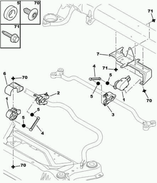

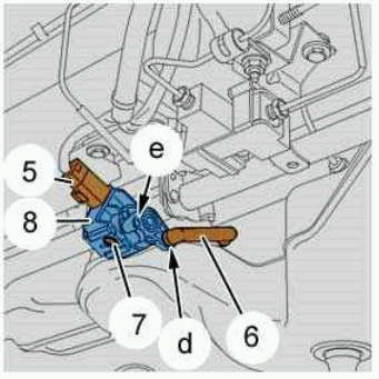

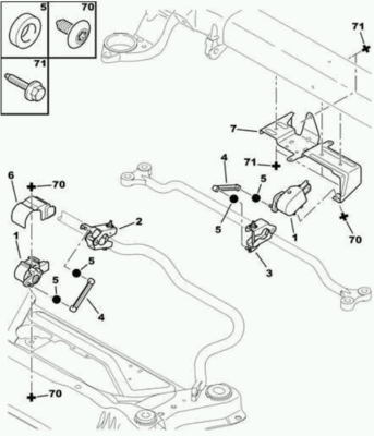

There could be a few possibilities. As you are in Greece, we don't currently have any members listed with Lexia kits that could help with a diagnosis. So I would start with checking the height correctors first. Be careful not to undo the clamps or brackets - as any movement will alter the height settings and will require resetting. I would make sure that the linkage is well-lubricated on each and then raise the car fully up and fully down several times to work the lubricating oil in. Here are the locations of the Front and Rear sensors:
Front (Spray around the ends of the linkage at 2 & b) Rear (Spray around part 6 & d) Overall (Parts 2 & 3 are the brackets that hold the correctors (1) on the Diagram - don't undo these or move them!) If your BHi (hydraulic pump) is raising and lowering the car ok, is would seem to be functioning - but if it struggles to raise the car up and the whining noise is strained - it may be that the pump is on it's way out.
