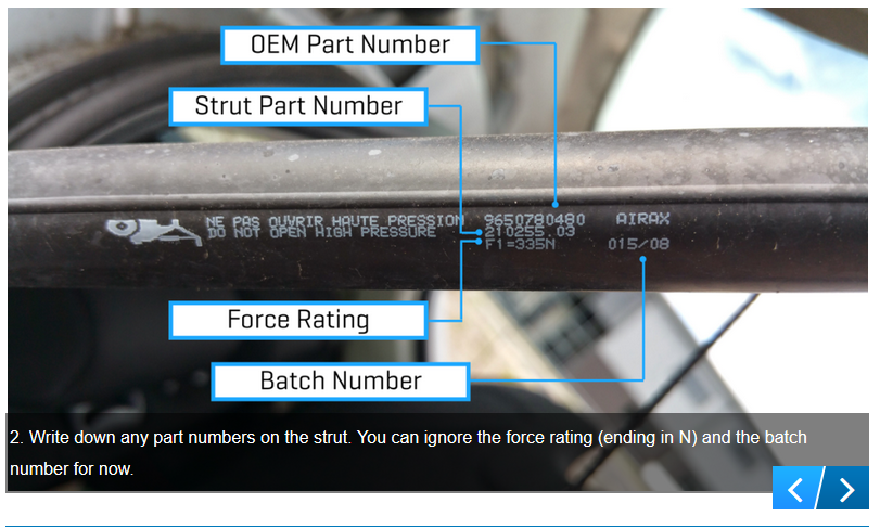

Here are the tailgate ones:
http://www.sgs-engineering.com/car-boot ... boot-strut
You just need to get the number off the old one begining with 9and it should match a single code with SGS for a direct replacement.
Here's a diagram: - then just search on the part number

Thanks Marc, i have had an email from them with a price which i am questioning to be sure they are quoting the right ones as the price is so ..well cheap, will get back to you when i have found out if they are right ones regards Pete

I know - I was surprised too and they're not made in the Far East either, so shouldn't rust by the end of the week!
