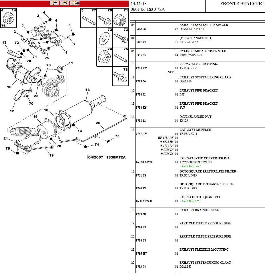

Can anyone tell me how do a no if mine has one please.
What oil should a use thanks.

As for the additive fluid, your RPO is 10073, which suggests you would have the EOLYS 176 at factory - and you should have the green 'click-fit' connector on the additive tank. Eolys 176 has now been replaced with INFINEUM F7995 for filling or top-up operations. This is what Citroen will likely use, but if you are unsure and want to be 100% certain check with the dealer.Taximan wrote:Can anyone tell me how do a no if mine has one please.
