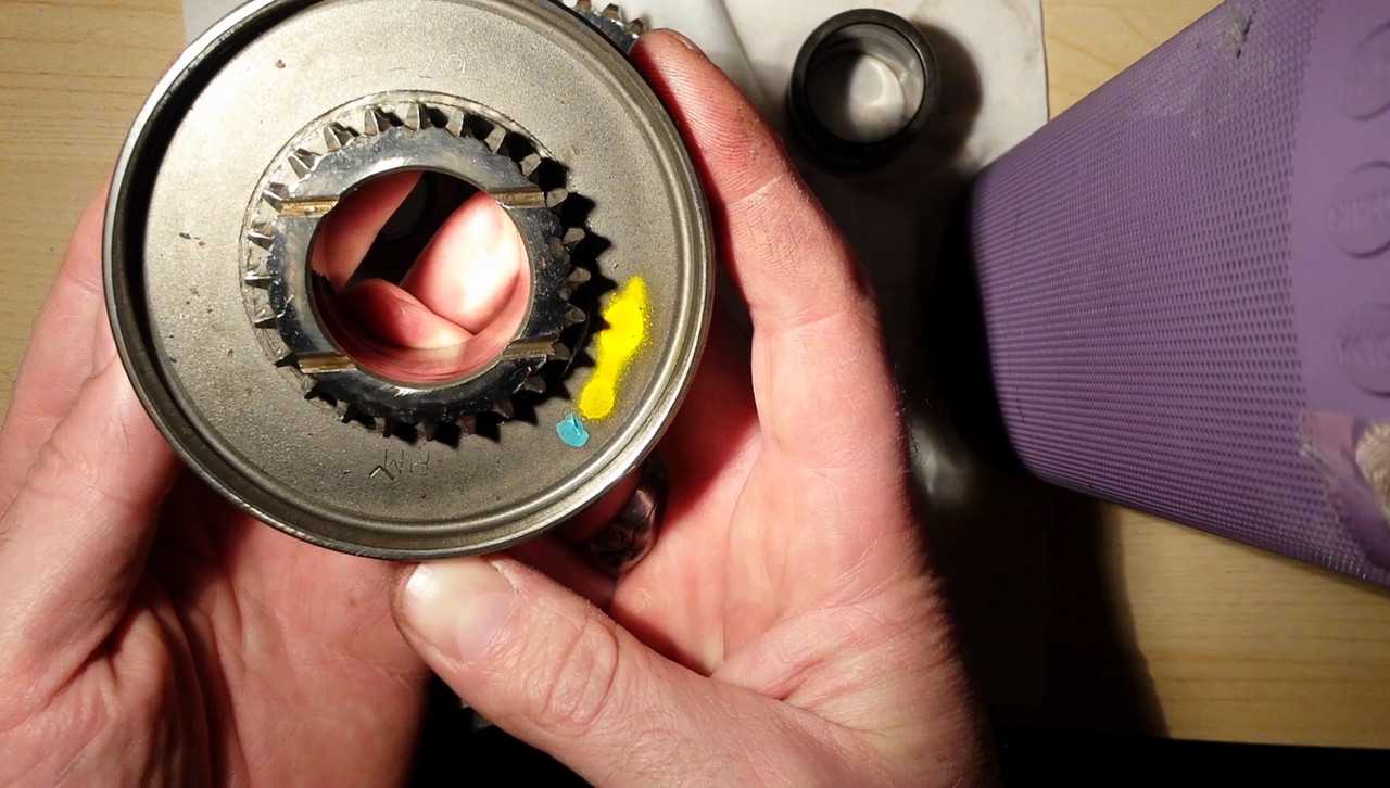

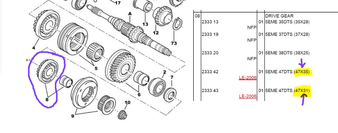

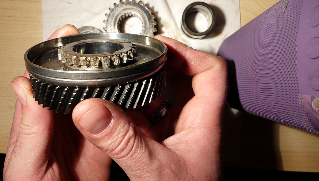

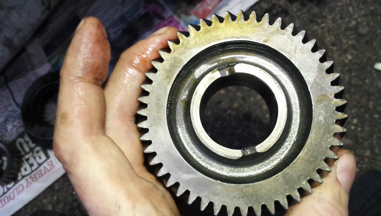

Anyone know what these numbers mean from the part numbers given for my fifth gear of my old Citroen Xantia 1.9TD 1996 Estate?
I think it's a BE3 gearbox.
(47x35)
(47x31)
Seems Citroen can't figure it out.
There are 47 teeth on the large cog on this fifth gear.
But the 35 or 31, dunno?
Closest dimension is the inner shaft but it's a whole 1mm bigger, I think when we're working with rather close tolerances, they wouldn't just 'make it up'?
Here's some measurements of the fifth gear.
Diameter = 90.5
Width = 26.7
Small cog teeth = 24
Big cog teeth = 47
Inside diameter = 32
Shaft splines = 22

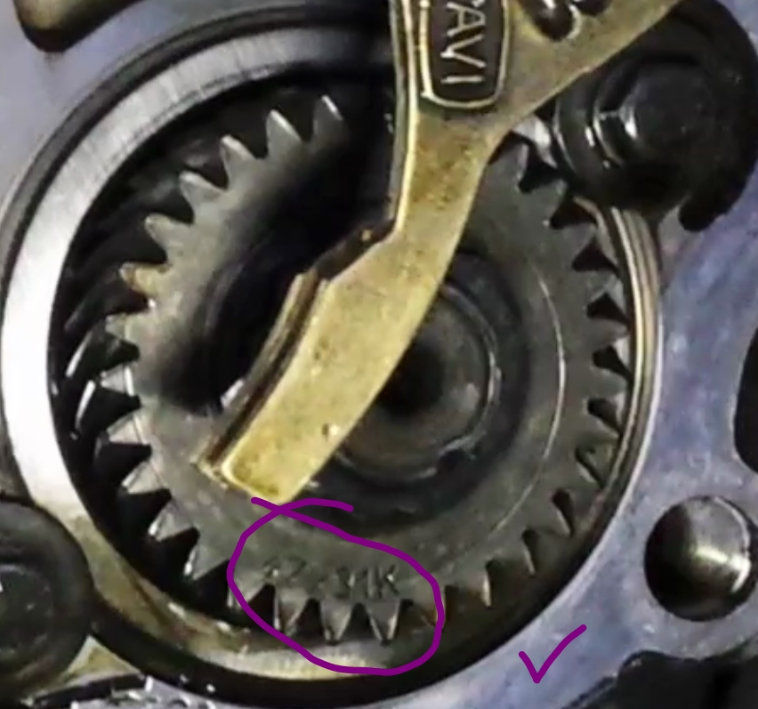

Gear ratios maybe, count the teeth on the gear it meshes with. my rough calculations give 47:31 = 1.51:1 47:35 = 1.34:1

Gibbo2286 wrote:Gear ratios maybe, count the teeth on the gear it meshes with. my rough calculations give 47:31 = 1.51:1 47:35 = 1.34:1
Was just going through a few videos of dismantling I happen to have with me at work..
YES!
SPOT ON!
Well done, fella!
No one else got this! :D

Romie, I say again, the easiest is to get a scrap box from a 1.9TD (any) and rescue the 5th gear assembly from that. Wear as you have is rare...

I do A LOT of 5th gear travelling in the Xantia.
Surf trips to Cornwall, 80 miles a day round trip to work which is ALL along the M40 motorway...
I tend to just get up to 5th then stay there until she stops :p
She has done 313,000 miles tbf
Dunno if this is 'young' still for a 5th gear failure?
Wish I could turn the thing round and use the other sides of the teeth! ;p hahah
I've noticed a few fifth gear kits around (not one for mine unfortunately)
Only trouble with getting another gearbox as a donor is:
1. I might not get exactly the right parts - (dunno if I have enough knowledge to get the right one :/ )
2. They might be in the same sorry state? :/
