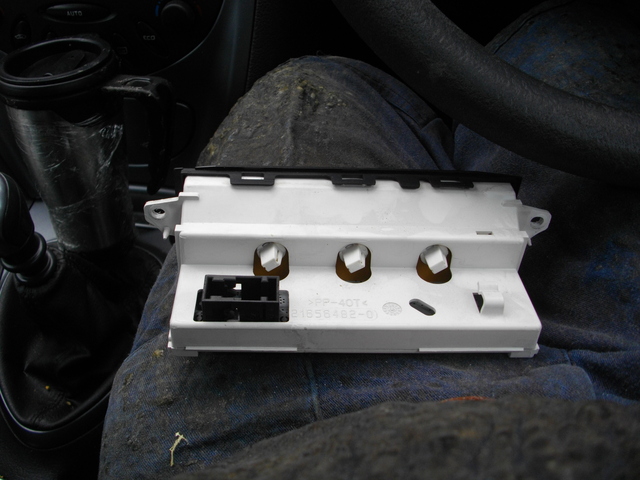

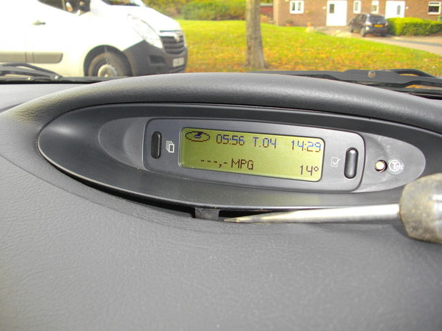

With a thin, blunt knife lift the centre of the surround until the tag clears the base
then gently ease the whole surround forward and clear.

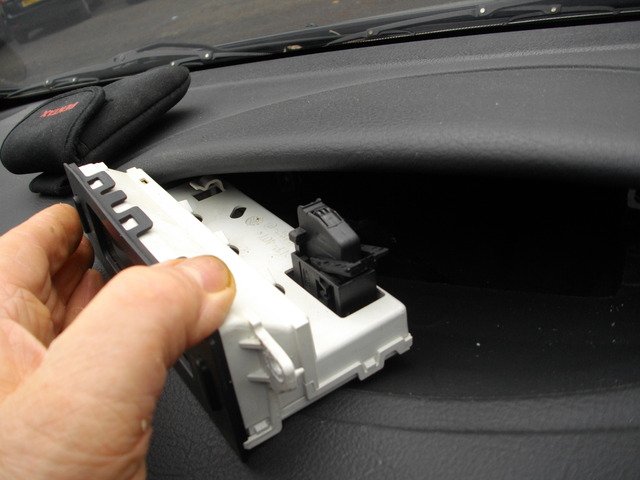

Using a torx 15 remove the twos screws and lift the display clear, release the lock on the plug and remove the plug.
On the back of the unit are three bulb holders, twist to remove then replace the blown bulbs.
Bulbs are these! 12V 1.2W capless type 285 - eBay listing

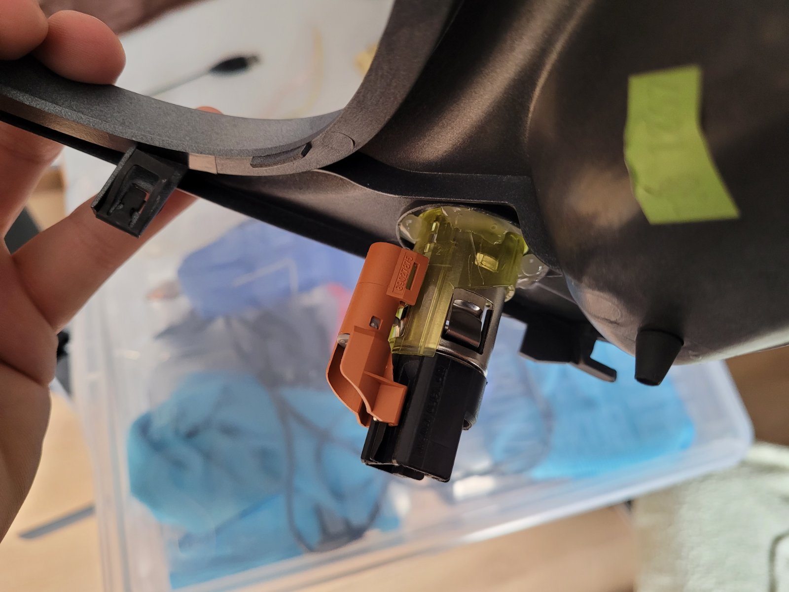

Yes, there is a light on the cigarette lighter. You will need to unclip the gear lever surround (and not just the leatherette sleeving) to get good enough access to the light bulb fitting (you can guess how I learned this). It is a normal capless bulb.

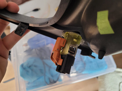

Thank you! I just changed mine. For the cigarette lighter, that one is not easy. It's a maroon socket that is pretty hard to detach and you run the risk of breaking it if it's cold. This one is from my small mod to add a secondary, surface mounted socket so I can use my large phone charger in the front.
Bulb socket
Bulb socket
