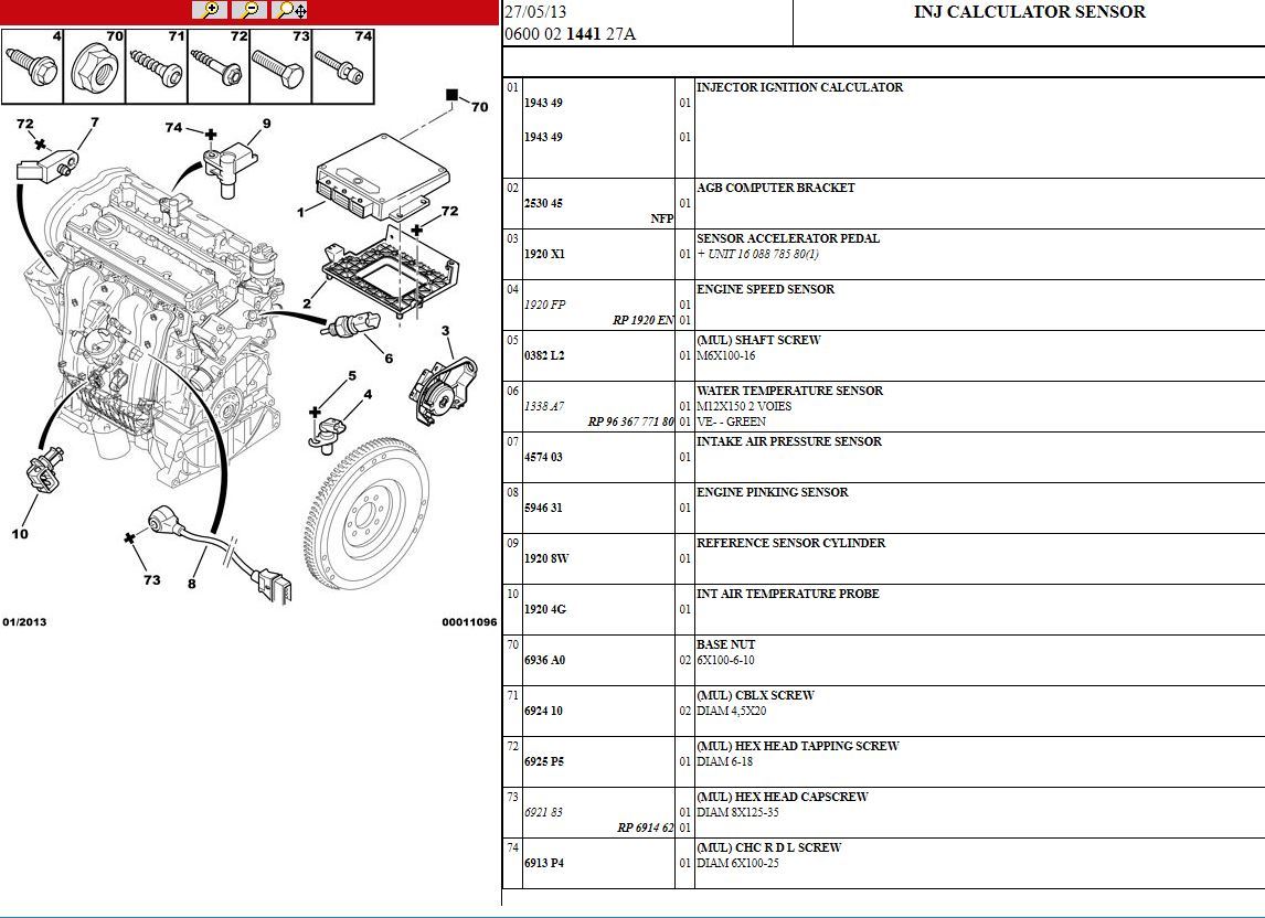

Hello to All
I need some help for my Citroen C5 2003, 2.0i 16V 136 HP with automatic gearbox.
Can someone help me to find where is the intake air temperature sensor? Or is there MAF sensor?
Thank you
x 6945
Re: 2003 C5 Air Intake Sensor
If you post up your VIN we'll be able to determine your exact model.
Unread post by Stickyfinger »

Thank you very much.
I was told that this sensor should be the root cause of my problems.
When the temperature is below 10 degrees, the cold start is very difficult. Sometimes i got "antipollution fault" error and the engine is working on 3 cylinders.
The engine is bumping hard until gets hot.
