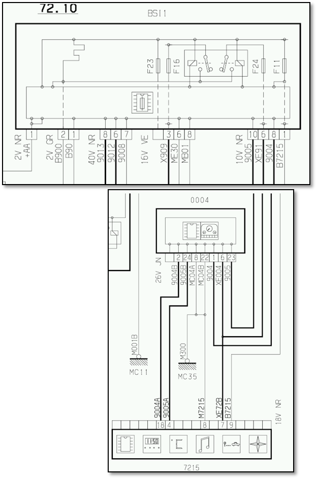

Re: C5 Mk1 computer powering down
- x 6955
Well here's the wiring section for the Instrument Panel, Multifunction Screen and BSI.
7215 is your Mutlifunction Display
9004A is the Comfort VAN Data Bus
9005A is the Comfort VAN data Bus B
B7215 is the Battery +
M7215 is the Earth
The 4 outer right wires continue up from the bottom to the top diagram so you can see where they terminate at the 10 way black connector at the BSI (10V NR)
M7215 is the Earth
bighairybloke
- Posts: 98
- Joined: 05 Jun 2016, 09:32
- x 7
Thanks Marc. Wow, where to start. I am not familiar with this type of wiring diagram. Looks like I need to verify 12+ at this 10V NR? Where is it located? And find where f11 is in the BSI box maybe? Are the BSi connections marked?

The wires should be marked with the code Steve - i.e. B7215 from the multifunction display back to the BSI where the fuse F11 is in the engine bay. I would also check the earthing points too.

Ok, first I checked the fuse 11 it is fine, there is no corrosion anywhere. Also, the earths all are clean and secure.
I also pulled plug Noir to check there was 12v on pins 1 & 8 and there is none. I suspect there is something amiss here? There should be voltage here to feed the radio and computer etc I believe.
The box with all the fuses and where the black grey and green plugs go in, is there circuitry below that could be faulty? Or a relay?
