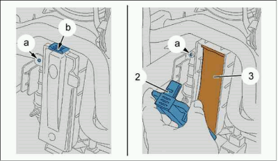

For your specific vehicle, according to your VIN:
Remove trim (1) under passenger side (diagram is for Left Hand Drive)
Unclip tab at (b)
Tilt, lift and remove cover (2)
Remove Filter (3)
Note: if tab (b) is damaged, position a screw for soft material fixing at (a)
Unclip tab at (b)
Remove Filter (3)
