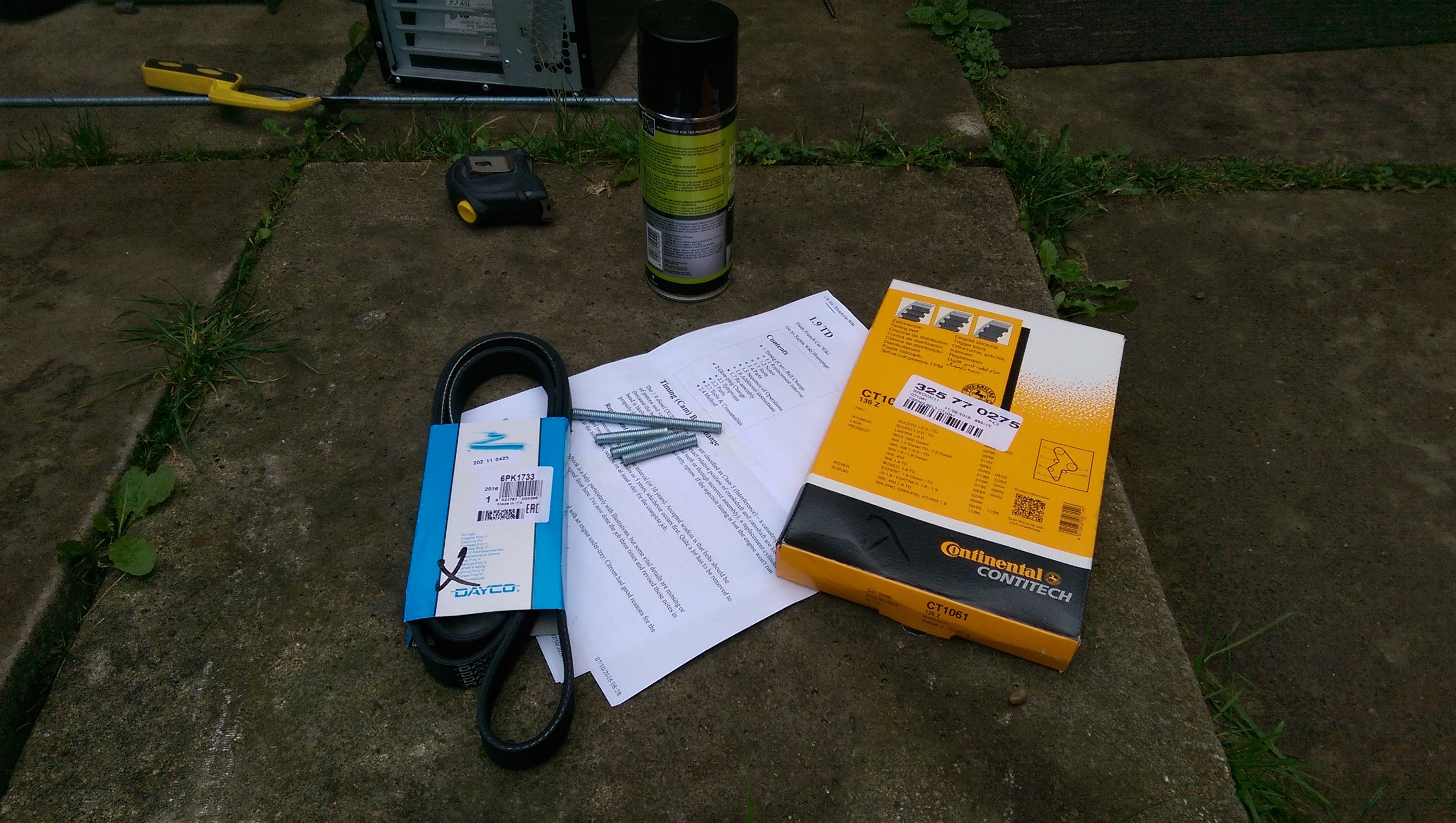

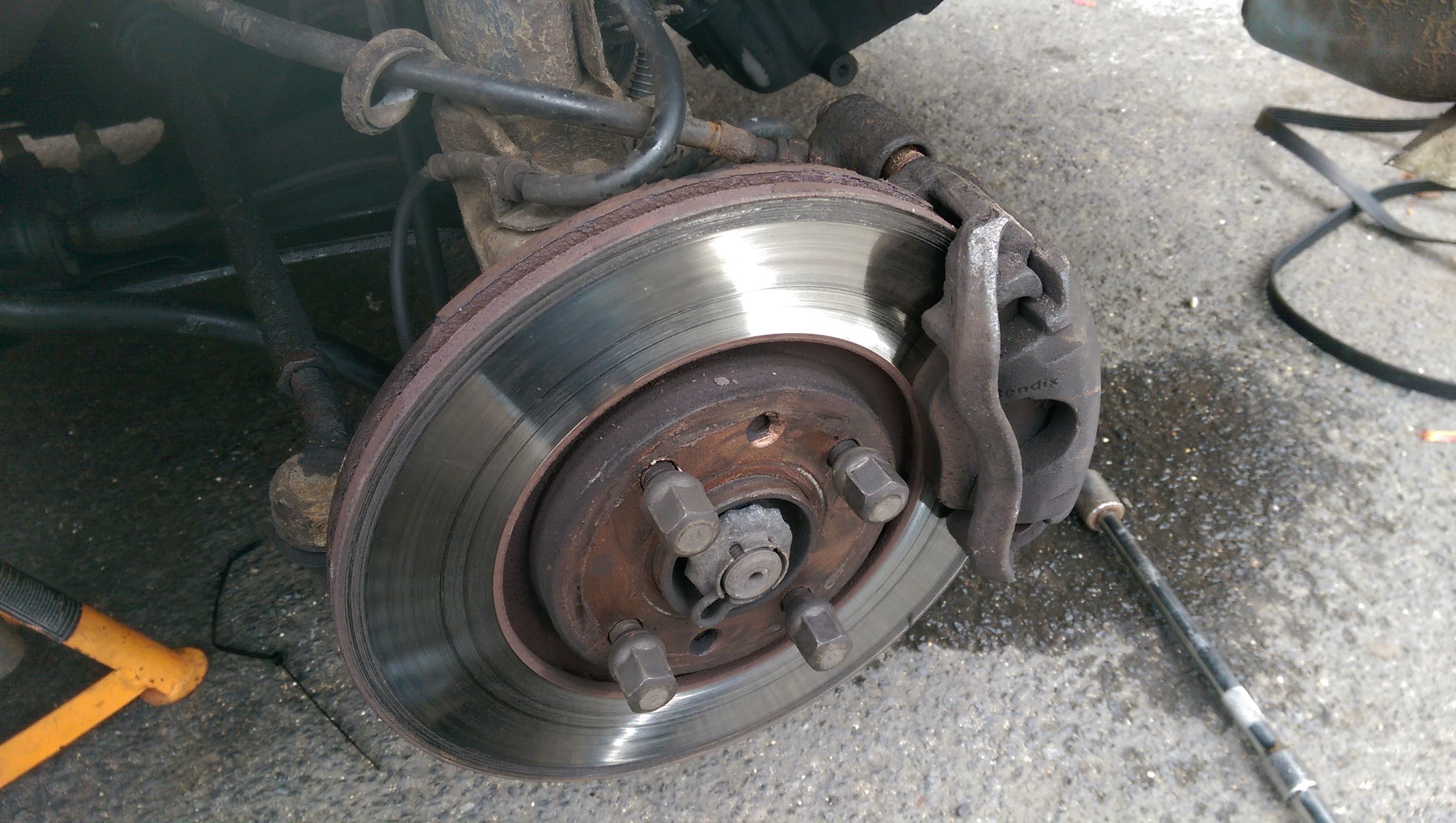

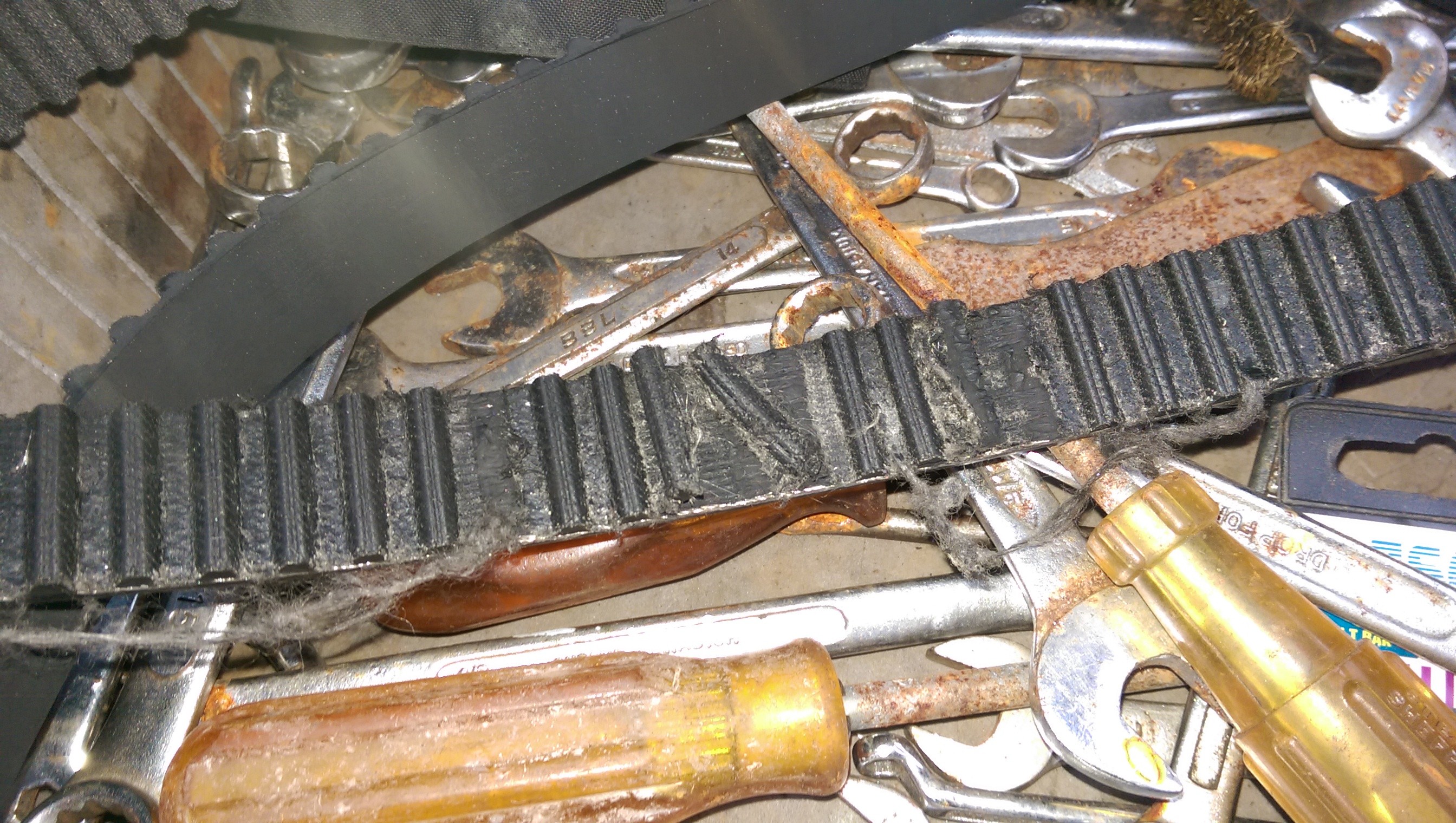

Right, let me show you what I've been doing today! First, I jumped in my girlfriends Meriva and popped into town to get some bits
Aux belt, cam belt, can of brake cleaner, m8 rod, cut up to make locking pins and the french car forum cambelt change wiki guide!

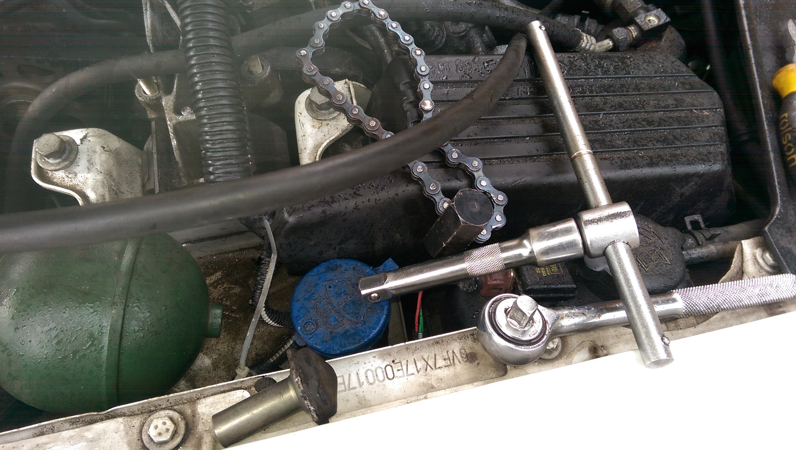

I started stripping it down, and quickly got to the crank pulley bolt. The gearbox was in 5th, handbrake hard on but it kept rotating. Took me a few minutes to work out that my front discs are missing the retaining bolt, so the driveshaft and hub were rotating behind the disc. Soon sorted that
and off it cracked, quite easily, but this is the third belt change this has had. Immediatly issues become apparent

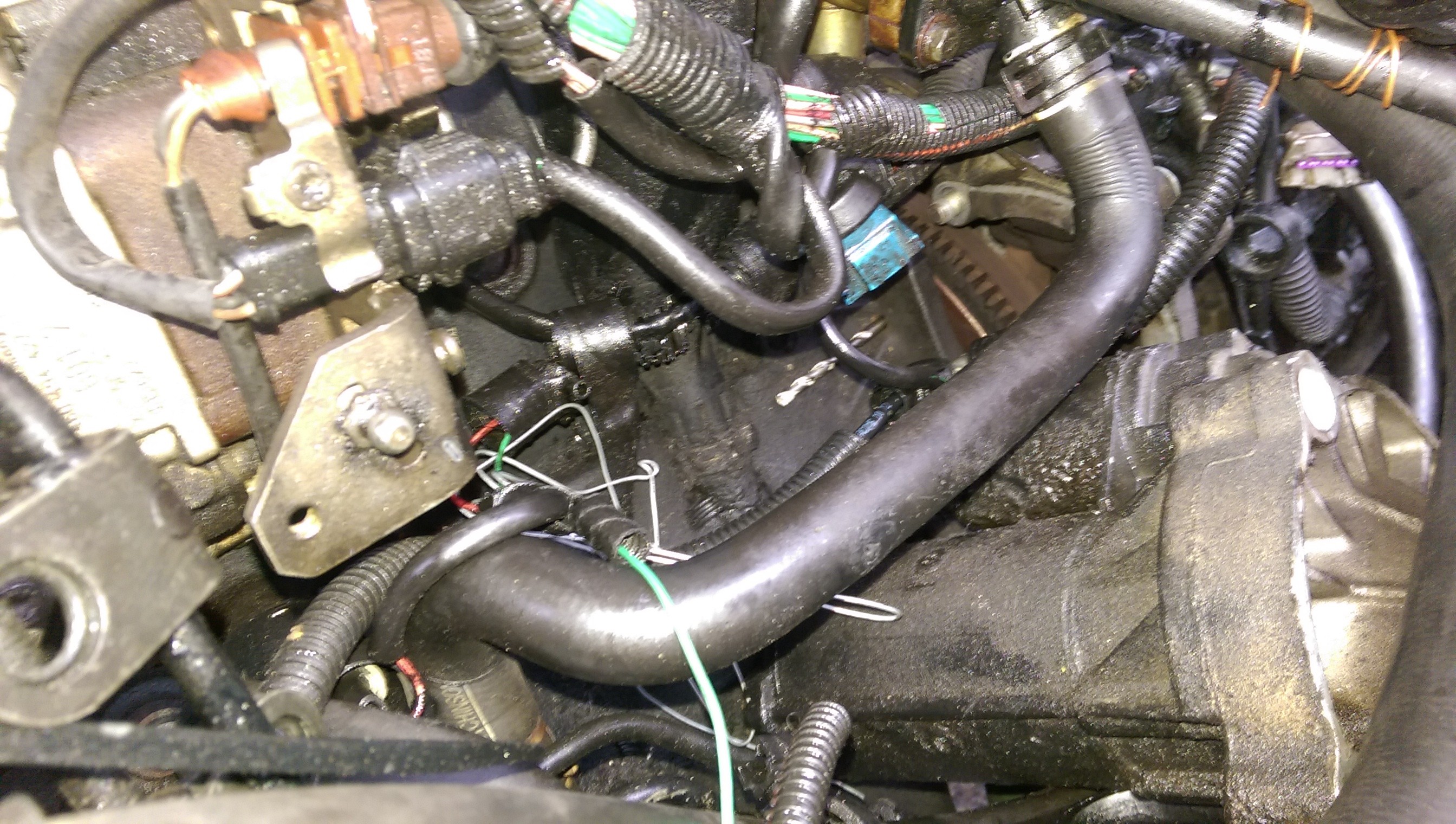

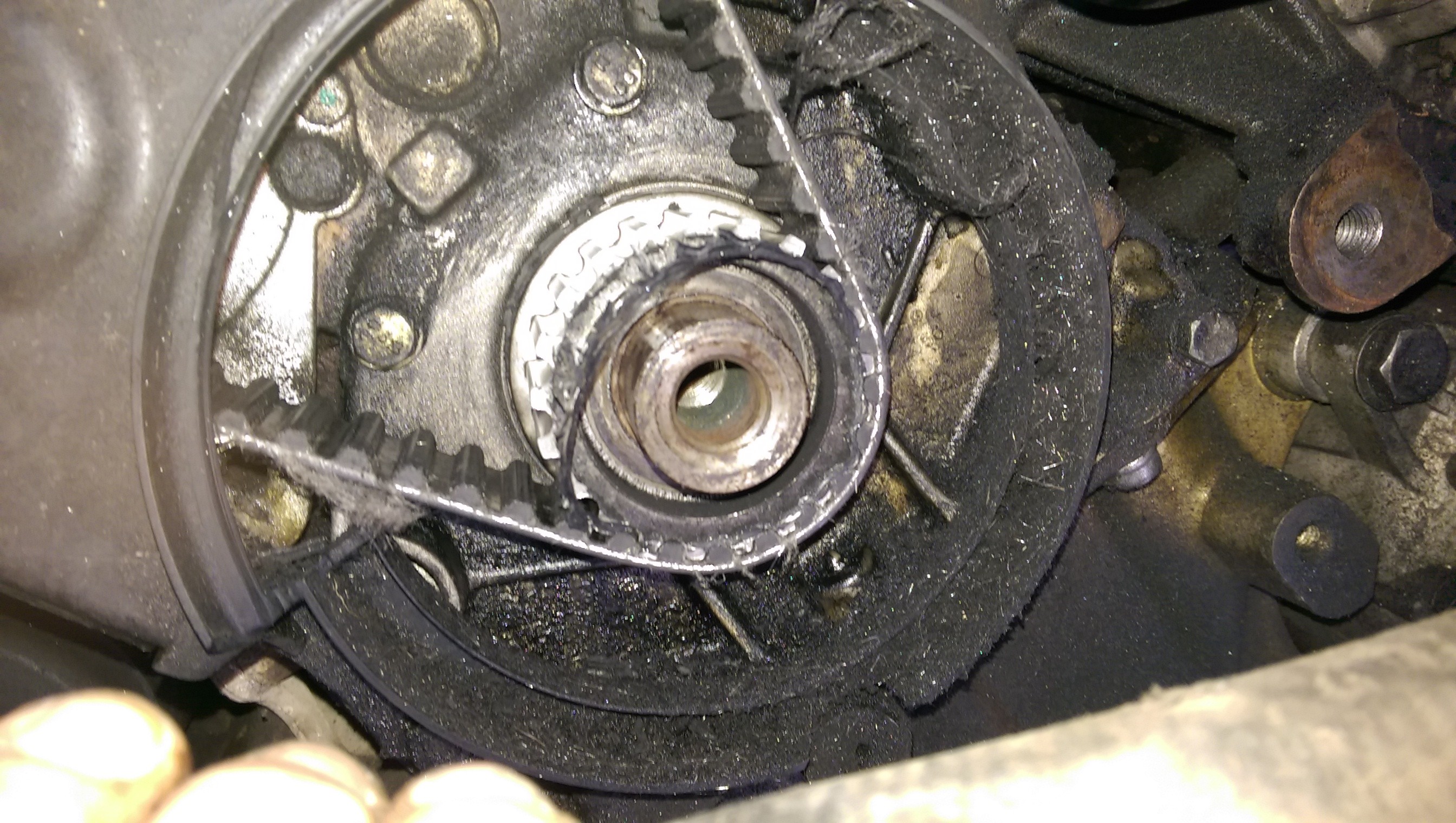

Moving on, I failed to get both intercooler pipes off, but luckily* the top cambelt cover is missing, and the main cover is broken, so with the pipes half off the cover was withdrawn (I re-read the how to and did find the mounting bolts to the intercooler pipe that isnt held in with a jubilee clip, so might remove it to refit). I then alarmingly saw a bit of plastic wedged under the cam crank

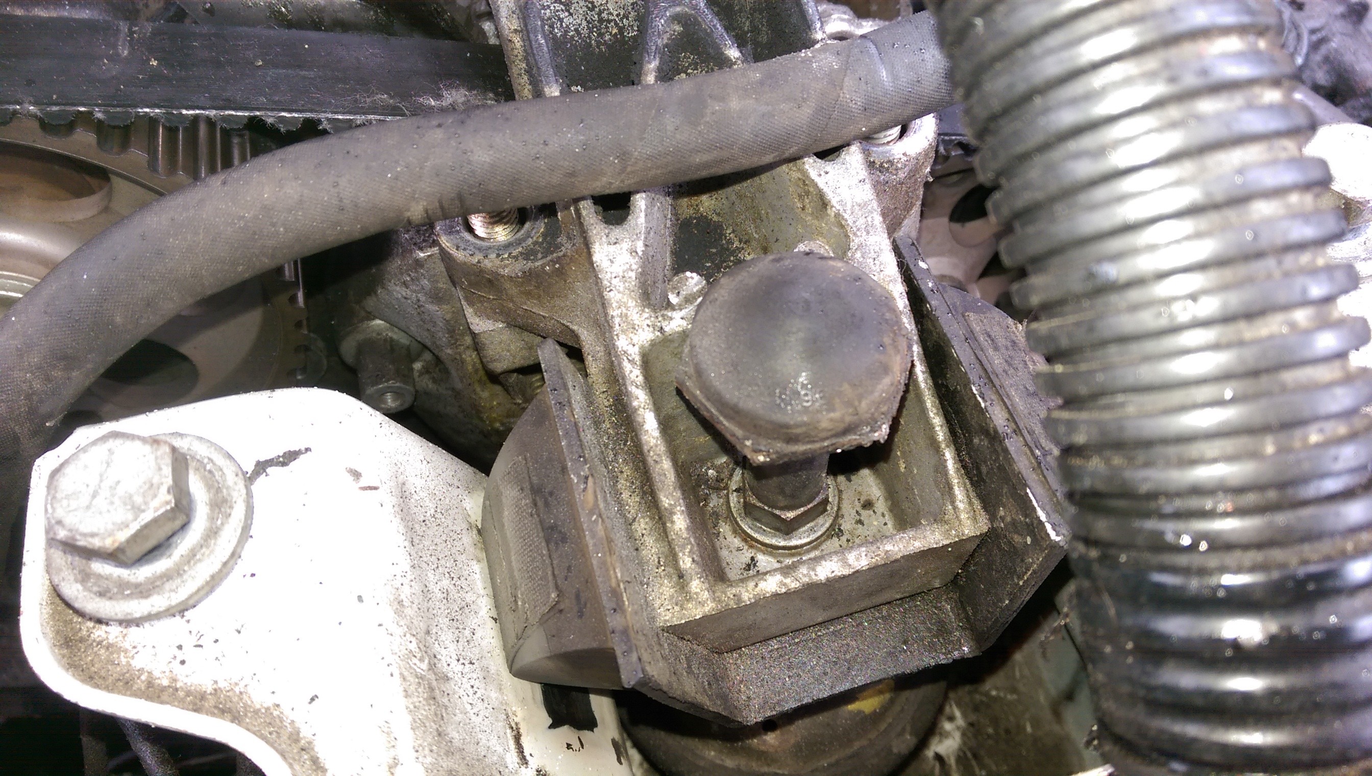

Some more bits were undone, then it came to the engien mount, and I haven't got a big enough spanner, adjustable or socker (32mm is my biggest), but luckily my oil filter wrench came to the rescue and cracked it off!

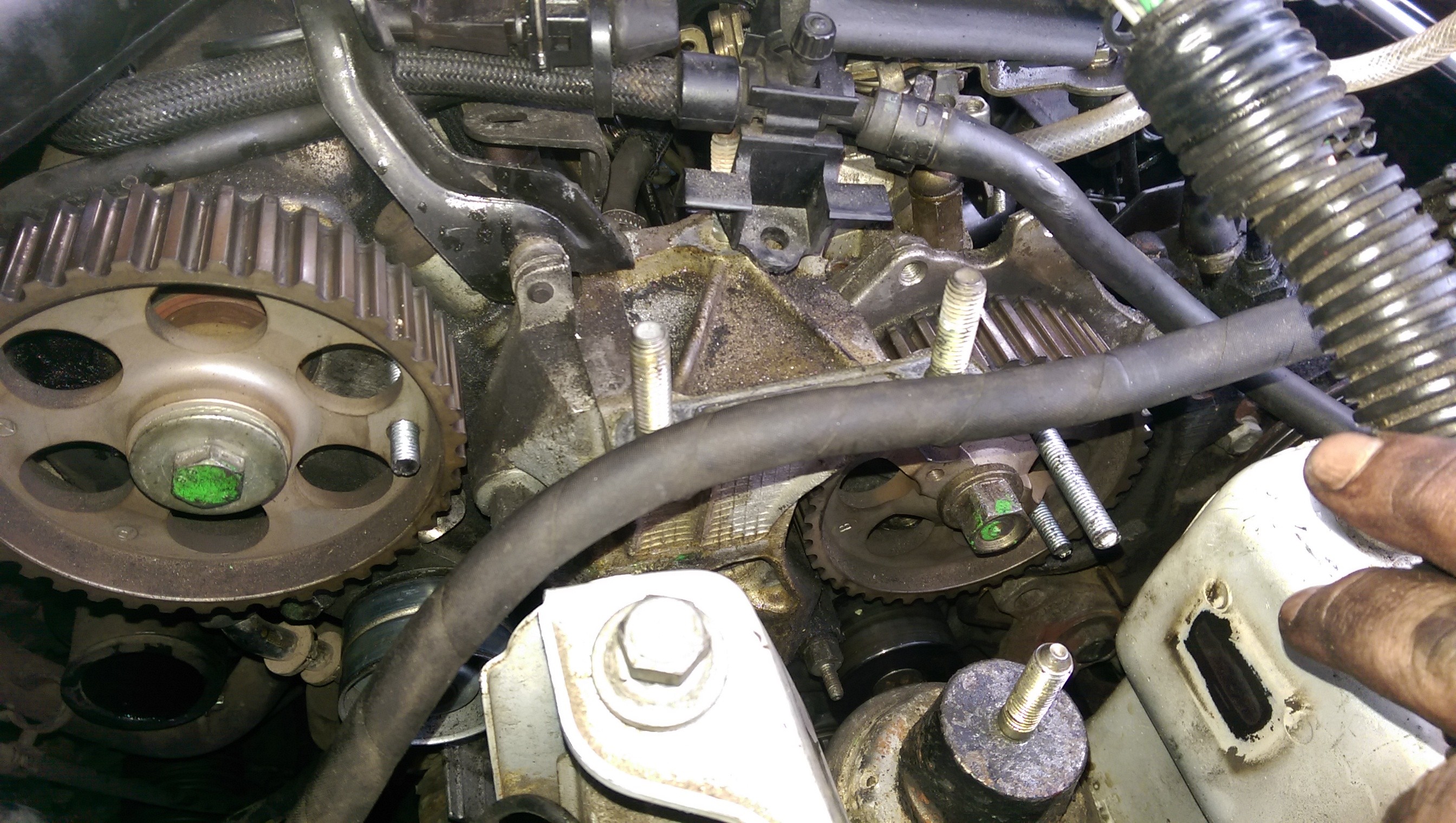

Next, I rotated the engine and locked the fuel pump crank. But then the cam crank wouldnt line up.... So, I took the starter motor off because I couldnt find the locking hole, and locked the flywheel and cam. Then, off came the belt, and I rotated the fuel pump and locked that (the fuel pump rotation was sprung, is this right?)
Used a 6mm drill bit to lock the flywheel, my m8 rod was too thick

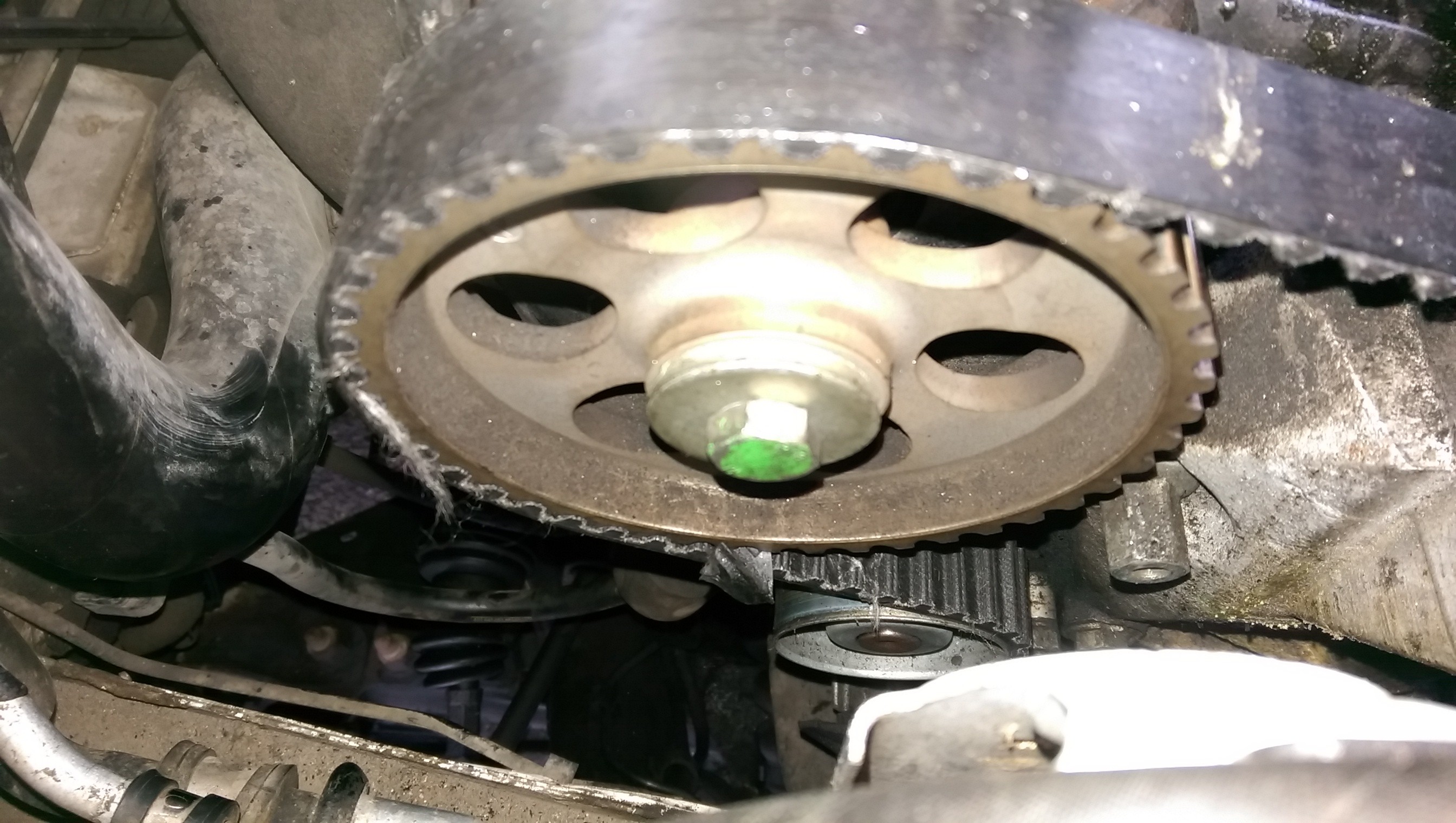

Amazingly, with everything locked up the bottom cog was at TDC, so I think the fuel pump was thrown out of time, causing the poor running and excessive white smoke
I pulled the cog off the bottom bit and fished bits of melted aux belt out from behind it
The full extent of how lucky I hope I;ve been is here...
