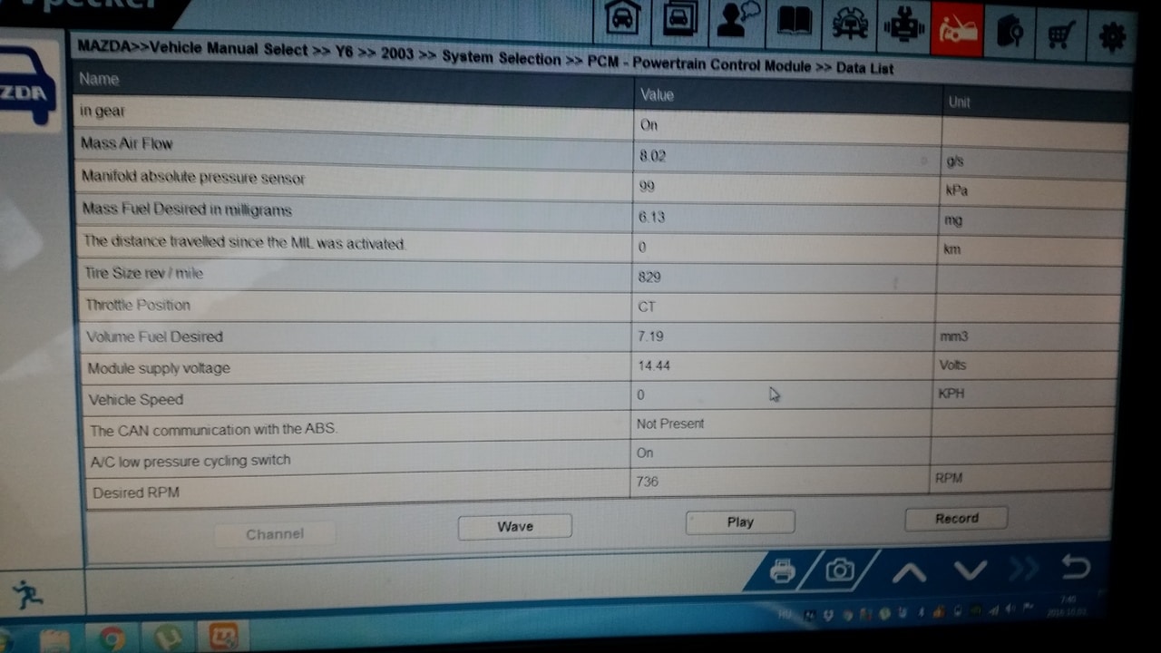

Sadly its a mazda and it was said Lexia wont work than i bought Vpecker and made some measurements:
video1: constant RPM MAF and EGR doing strange things (MAF controls EGR? ):
video2: at engine brake EGR close:
video3: at idle
Sadly Vpecker has these datas. Maybe bad quality EGR? Bad mixture of fuel ? Bad timing? Also if the injector seals good where comes the oil? I am really disappointed after these expensive repairs.

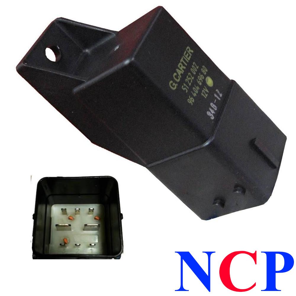

Thank you for your advice. I will change the glow plug relay when is have time. Do you know how to measure if the plugs fine or not?
From six little leg 4 is for the glow plugs right? With continious reading i can check the cabels wich coming from plugs to these little legs + ground?

The only reliable way to check glow plugs is to remove them and apply 12V to them. Observe that they start to glow near the tip. You can check them for resistance whilst they are still in the engine (less than 1ohm) but they can have an internal failure where they heat back at the threaded body rather than the tip.
You may have a problem with the relay but I think that faulty plugs are much more likely. The plugs are fitted to the back of the engine. The first check is to test with a test lamp that they are getting supplied when the ignition is turned on. They are only activated for a very short time. There might be also a post heating function where they are activated or often pulsed on and off for a period after the engine is started. Even though this is entirely a PSA engine often with the same injection and control systems the software can be considerably different from one make to another. You need to check the information specific to Mazda.
