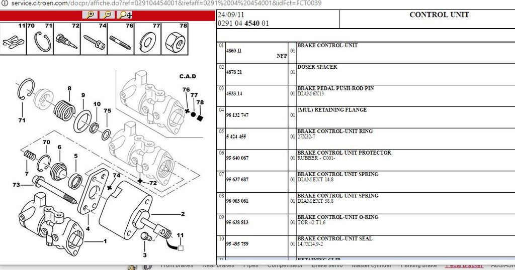

Re: Xantia HDI 2.0 90CV 2000-Mystery hydraulic leak!
They're talking rubbish:
You need item 6 and 70 and maybe 5. Citronut used to reckon that they were doable with just undoing the two bolts that hold it to the bulkhead, then easing it into the engine bay, levering off the old cap and fitting the new one. The complete valve is, in fact, no longer available.
in the UK parts can be had for <£20:
Part Number Description Price excl. VAT Price incl. VAT Total incl. VAT Selection
0000697801 STOP-RING 0.91 GBP 1.09 GBP 1.09 GBP
5424455 CNTRL-UNIT RING 5.88 GBP 7.06 GBP 7.06 GBP
95640067 BRAKE PROTECTOR 7.53 GBP 9.04 GBP 9.04 GBP

FRJoey46 wrote:Thanks to everyone for their advice...a citroen specialist looked today and it was a massive build up under the foot well compartment indeed.
Delighted the problem has been found
Yes, as Richard says, garage is talking rubbish!!!
