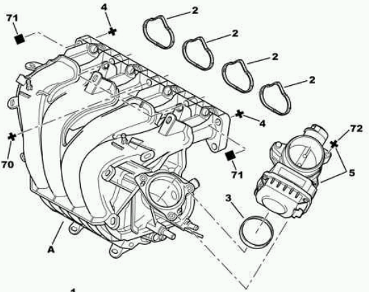

Right - yours will have the throttle body control valve then, Part 1635 X0 (No. 5 in the diagram). If these get gunked up they can cause bad idling and hesitation. Although you may be able to clean the butterfly valve in situ - a lot of the crud can gather at the back. There is a video on cleaning these below the diagram (it is a long one, but you can skip to the cleaning part - and is a generic procedure).

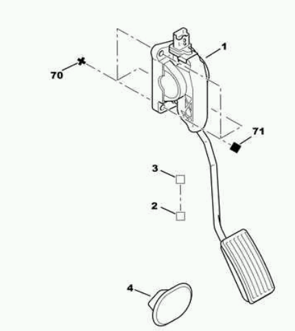

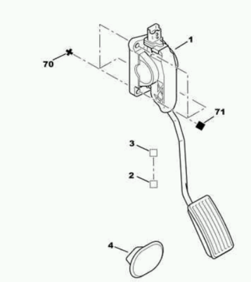

No problems, the throttle body control valve is a complete unit PSA part number: 1635 X0, but don't forget you have the 'fly by wire' accelerator pedal too, Part 1601 Q4.

As the accelerator pedal is expensive one to replace – is there a way to check if the current one is ok?

So you have cleaned the Air Doser - Can you confirm you changed Part 8 on the diagram which is the Intake Air Pressure Sensor?
