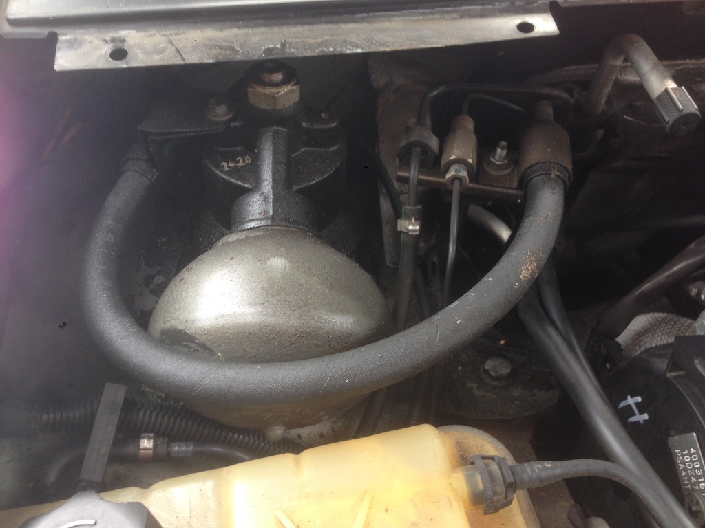

Anyway - obviously it's a new car to me so there are a few issues I'd like to sort, firstly we noticed that the top of the drivers side strut and sphere is wet, as though there has been either a slow leak, or as though it has been splattered with oil and not cleaned off, see the picture below. It also seems like the high pressure hose is a bit too close to the sphere as it is touching - as can be seen by the line of oiley dirt:

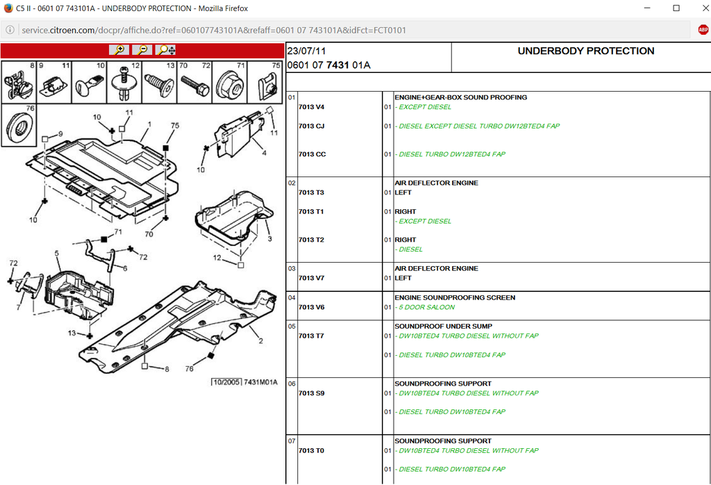

Secondly, it has half of it's undertray missing - does anyone know if these are the same across the board? Ie will any C5 undertray fit? The part number for mine that I found on ServiceBox is 7103 CC - I can't find any on eBay and from Citroen they're pricey!

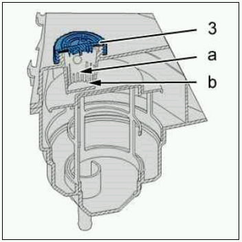

First of all I would recommend that you clean up the area around the sphere - so you can tell if there is anything leaking - it could simply be general muck and oil spread. As far as the struts are concerned it is common for these to 'weep' a little - often causing the uninitiated MOT tester to go into fail mode - generally cleaning up gently around the are will again determine of it's a more serious leak. No sense in panicking unnecessarily. Check your LDS by putting the suspension to the lowest setting, wait until it has fully lowered then check that the fluid is between the a and b in the diagram below:
See how things go after you've cleaned up the areas.

Thanks for the replies guys, I had seen the Polish version but thought they mentioned "good" quality far too often to actually believe it! Typically it looks like the engine code I have has it's own undertray version, at a bargain £186.62:
I don't think there are many of the BTED4's up for sale at all let alone in the scrappers which is a shame!
Regarding the suspension leak I was planning on cleaning it up and seeing if it reoccurs, which I think is what I'll do. But does anyone know whether the hose should be touching the sphere or not? Seems very odd for it to be touching like it is. I hadn't checked the LDS level yet because I'd read horror stories of the tank being pressurised or something - am I barking up the wrong tree? I do however have 2 bottles of LDS from when I previously went to view a C5 (long story).

While the system DOES need to be pressurised for it to work (mainly to prime the pump, after the system has been de-pressurised), you can (with the suspension down to its lowest setting) safely take the cap off the reservoir (and, in fact, you should do so when any of the wheels are coming off the ground, such as when you replace a wheel). Drop her to her lowest setting, turn off the engine, and take a look. LDS should be between the lower and upper vertical slots (these are the level indicators).
