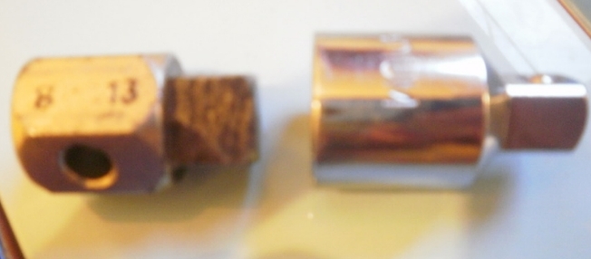

Yes it would be nice if there was a metal plate which you unbolted from the inner wing area which gave you unrestricted access to the cambelt end of a transversely-mounted engine. Save all that fiddling about in a space too small for fiddling about in, and all that creative thought put into how can i undo that bolt when all the tools and sockets I have are too wide!
Here's one of my adapted tools....has come in useful many times in restricted space bolt removal, or tensioner winding back...its a drain plug socket with the 8mm square end ground off, leaving the hex which can be acted upon by a ring spanner and the 13mm square ready to receive sockets. Using the 1/2 to 3/8th adapter is useful for the tensioner.
