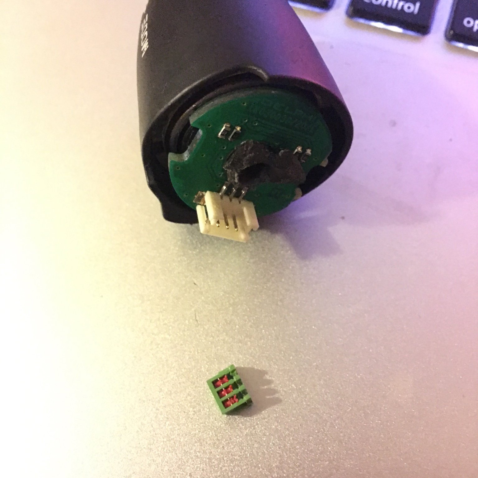

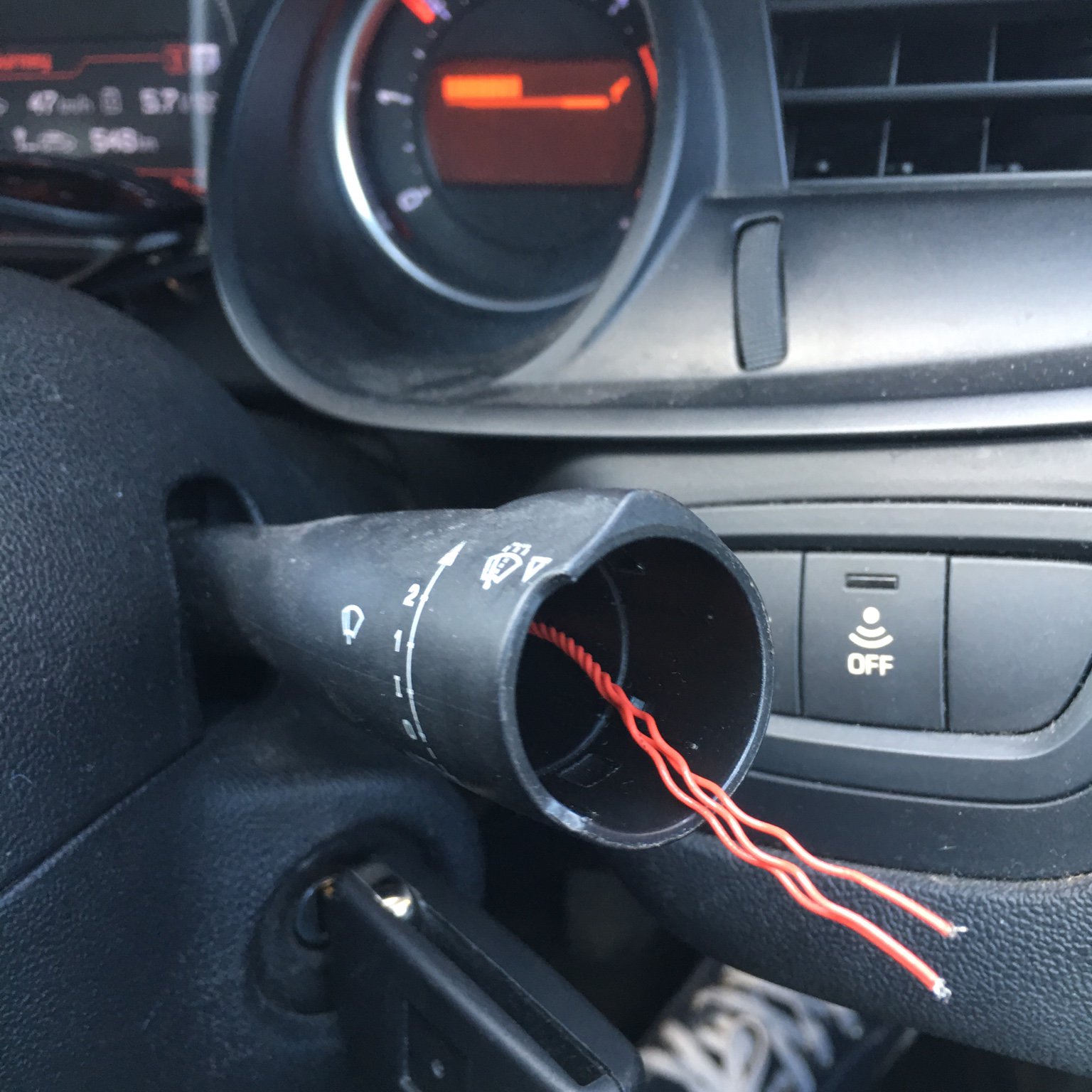

Hi guys, I need to fix the wires that goes through wipers stick to MODE button but I don't know how to take the stick off. Does anyone have a service diagram or something?
Thanks!

Hi Todi - I think you'll find there aren't any wires as such - it's all printed circuit - what seems to be the problem? Issues with wipers / lights can often be attributed to the Comms unit under the steering wheel. The Wiper control stalk is supplied as part of the Comms unit IIRC.

"Mode" Button brokenGiveMeABreak wrote:Hi Todi - I think you'll find there aren't any wires as such - it's all printed circuit - what seems to be the problem? Issues with wipers / lights can often be attributed to the Comms unit under the steering wheel. The Wiper control stalk is supplied as part of the Comms unit IIRC.

Probably your best option is to get a spare as VB says Todi - there are no stalks available separately from Citroen - all come as part of the main module and I've checked the wiring - nothing there that will help.

I think I can fix them, I think is a problem of wiring, just need to know how to take them of and the which where.

Maybe Vborovic can look at his spare module if it's a matter of which wire goes where?

I can take a look in the evening, but if I recall correctly, the wires/pins aren't easily visible nor accessible (I'd definitely have to break the enclosure apart and there are no guarantees I'd be able to bring it together and what I'll find underneath)

Does the wiring diagram not give pin numbers and wire colour?

Don't know that but as you can see in the first posting, there are no colors on those wires, there are 3 red wiresPaul-R wrote:Does the wiring diagram not give pin numbers and wire colour?

If they're all the same colour then you have a problem anyway and would need to find the other end of the wires to see what goes where. Sometimes the wires have tiny rings that slip on and each ring has a different identification on it - I can't see those in the photo but is there any sign elsewhere of these?
The fact that they are twisted together tightly implies to me that they are data wires. You could damage ECUs if they are not connected correctly.

I did look Paul - but I can't see any of those wires as they are internal to the stalk - the only wiring is for the activation of the wash etc on the main diagram - I think it's much like an electronic module - you'll get wires to the connector but nothing internally. A visual is likely the only way I think as these are not supplied as separate parts.
