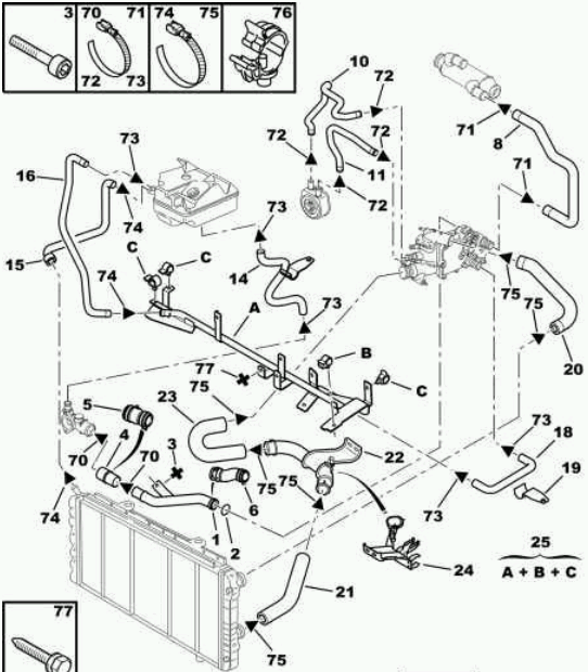

Re: Mystery coolant leak, please make it go away!
Ok, so here is the diagram for your vehicle - I've just put a simple key below to show only the numbers for the hoses, as there are wiring sheaths in the diagrams that could be confusing:
Number Key for Hoses:
01 WATER EXHAUST BYPASS PIPE
DIAM 32 LG 282
04 WATER HOSE
DIAM 32X36 LONG 80
08 ENGINE WATER PIPE
DIAM 22
10 EXCHANGER WATER INLET HOSE
DIAM 14X16 LG 603
11 ENGINE WATER PIPE
DIAM 14X16 LG 433
14, 15, 16, 18, 22, 23 & 25 = ENGINE WATER PIPES
20 = RADIATOR WATER INLET HOSE
21 = RADIATOR OUTLET HOSE
I hope this helps track them a little easier.
Unread post by Citroen Surf Bus »
Thanks for that, great stuff.
I'm not seeing any heater hoses on there, strangely. I'll do a picture search and see if I can come up with a photo of the rear view of a 2.2 HDi ...
I'll keep my fingers crossed it's not a core plug, Chinkostu. That doesn't sound much fun at all. ) :
