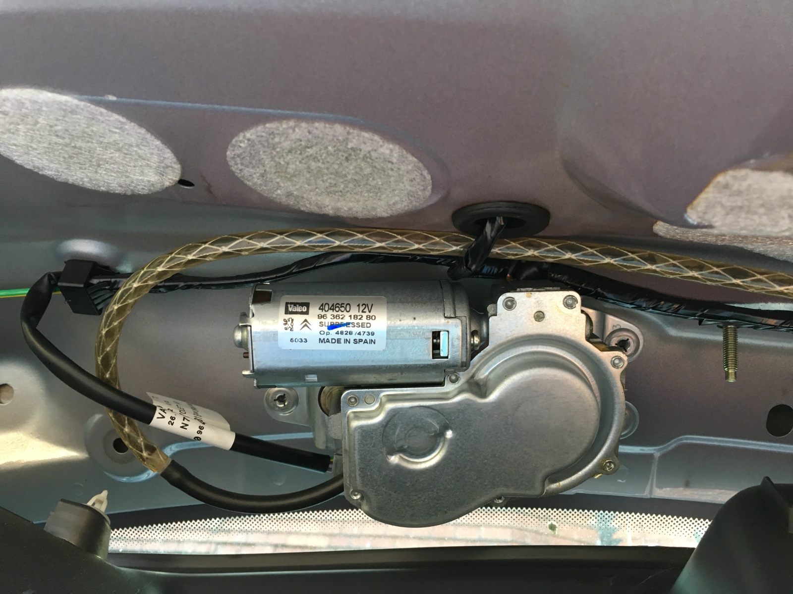

This is the existing solenoid? that goes to button on the boot.
Would the extended wire from the central locking kit go to one of the terminal in here?
Thanks

Errr thats the rear wiper motor. The boot release motor is integrated into the catch & has a three pin plug, will need to look up the pin number as i cant remember off hand.

Hi Wheeler,
I now know the following:
*that motor is the rear wiper
*the clear tube carries the liquid.
Didn't expect the rear wiper move when I injected 12V. ha
The switch looks quite small I expected something different than that, probably bigger, I need to explore again.
The button does have a plug in it with maybe 3 wires I can't remember.
Thanks
Mike

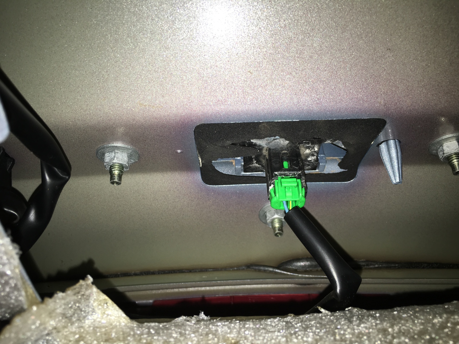

No, there is a 3 pin plug on the actual catch, the bit that holds the bootlid shut. Its inside the lid, you need to pull back the foam cover & look inside the tailgate.

chigurhm
- Posts: 45
- Joined: 09 Jul 2016, 22:29
Re: Xsara Boot Release (2003)
Good Evening,
I can't thank you enough Wheeler for the information and advice, and Marc for supplying the wiring diagrams. I now have remote central locking on the 2 front doors and a boot release that work - I ran a wire to the pin you described and it worked. I haven't completed the rear doors yet as I need to strip then and try to fit the actuators, it was hard to fit them at the front and I don't know if there is enough room inside the rear doors. The wires are ready to go when I decide to do this.
