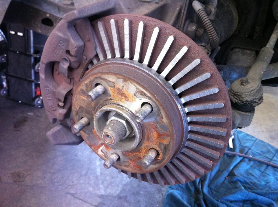

Re: Rear Calipers / Discs / fitting kit - Xantia Estate
Just don't let them get this bad !
