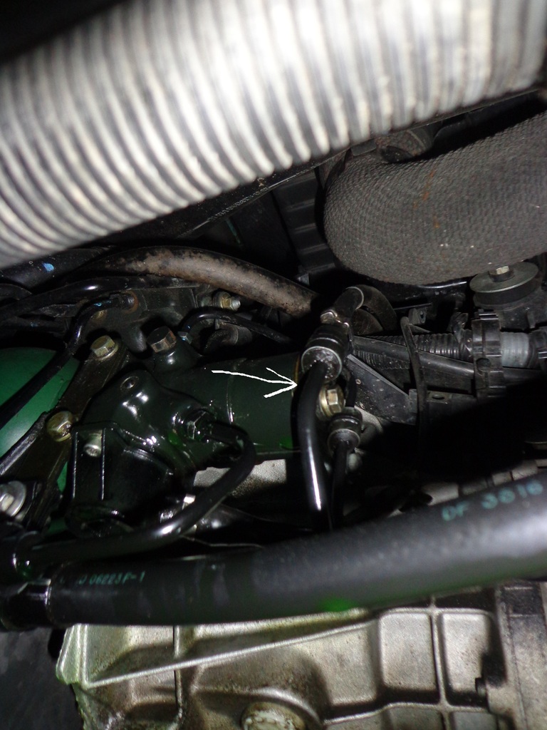

This is showing a LMH leak from the accumulator assembly on my 93 xantia sinker, it appears to be coming from behind the arrowed plate, is there supposed to be an O ring or gasket behind the plate ?http://i329.photobucket.com/albums/l386 ... C02083.jpg

Yes, there is a big O Ring under there but replacing it is a bit of a specialist job as there's a C clip to remove and a big, hairy spring behind it...
Deanxm of this parish has written up how to do it in your own workshop. A search should reveal the thread or if can't be found on here have a look for it on club-xm.co.uk...

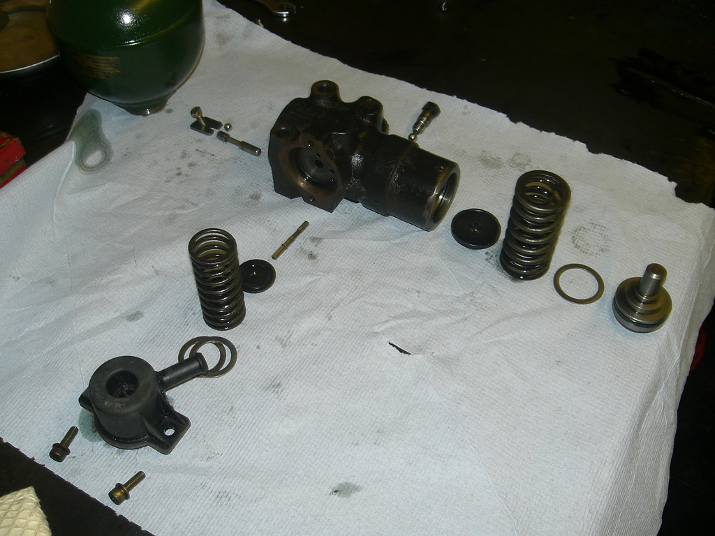

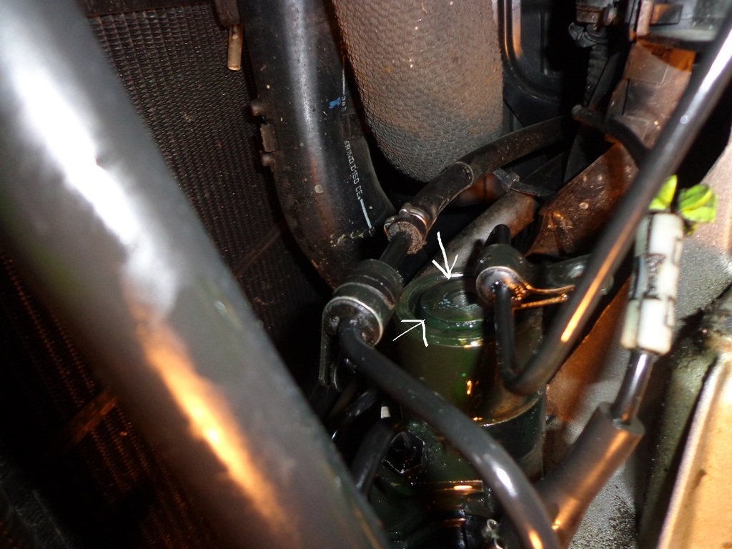

Thought I would try to do the O ring without removing the reg from the car. Used a large F clamp to compress the end cap, got it all apart and replaced the O ring but managed to damage the O ring getting it back in, I think it got hung up in the cir-clip groove . So after work I removed the reg from the car and did it properly, my vice was only just big enough but got it all done. Thinking about the support bracket on the end of the reg and how AndersDK mentioned how its possibly the cause of premature leakage, Im going to have a look at redesigning the bracket so it attaches to the reg body and not to end cap......

V6s suffer from early leakage from where yours did and we always put that down to the extra heat in the V6 engine bay close to the regulator...

If failure after 23 years is premature, then how do you think C5 X7 owners feel when their steering racks are leaking after 2 or 3 years?kiwifrog wrote: ...how its possibly the cause of premature leakage, Im going to have a look at redesigning the bracket ......
I think the real problem is that citroedn generally used nitrile O-rings, which do harden with heat and time. Replace with Viton O-rings and they should outlast you.

The springs set the pressure and how many depends on calibration so nothing to worry about....
