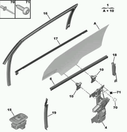

Re: Rear right window won't close
I think your window is likely to be popping out of its track when at the bottom, trying to raise it it comes against the anti pich and goes back down.
You need to get inside the trim and see if the bottom screw of the track has dropped out or if the track has somehow come apart.
Usually you can get the window to close by pulling the top of the glass forward so that it pops back in the track.
x 6945
Yes, Gibbo's right - that's another possibility - if it's lifting out the riser at an angle it will 'wedge' causing the anti pinch to kick in - so as you have the door card off at the moment, you should be able to hear if the motor is meeting resistance when it hits the spot where it reverses.
Here's a diagram to help you:
10 are the 2 clips that the glass sits into - so check these are gripping tightly and that the glass is sitting flush in the clips.
