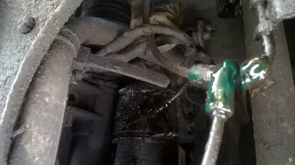

Hi, my S1 Xantia's steering fluid return pipe has a green plastic connector(see photo) mine is broken !
anyone know what' its proper name is
? as I am guessing it is a 'Citroen Only' part. many thanks Terry.

Ahh yes, a Y connector.. Yes indeed a Citroen part only but as it's just in the low pressure return side of things an adequate substitute may be available from a purveyor of aquarium supplies...
Just check that whatever you get is LHM-proof by soaking it in said stuff for a few days...
