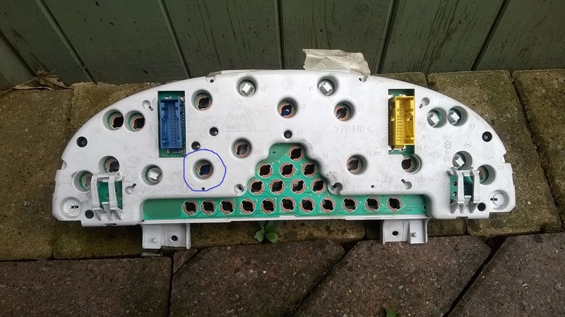

In addition to previous info, there's also a screw at the top of the instrument cluster itself. Here's the back of the panel showing which bulb illuminates the odometer.

cheers ken what type of bulbs are they in there and is that panel working and spare. message me i'll take it off you if I need it.

They're the tiny "grain of wheat" bulbs.
