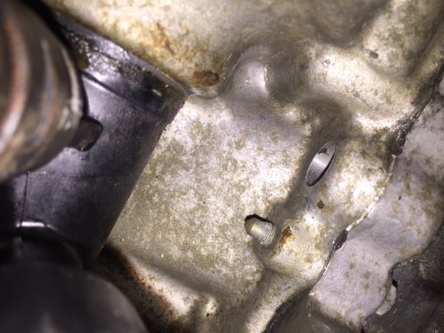

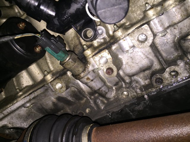

Re: Coolant leak !!!
The top picture is where it is leaking. This whole section is loose ?
Should there be a bolt in the other picture where the plastic has a metal bush inserted ?
Update
Managed to get a new bolt and fit it to the plastic manifold section and seems to have fixed it strangely ? Had to use a bit of force to get it into the right position to get the bolt in so guess the bolt had somehow worked loose and popped out while driving causing the whole section to move as it is under tension in the correct position this must have been pulling on the joint between the pipe and the engine block at the back of the water pump. Nice easy fix in the end
