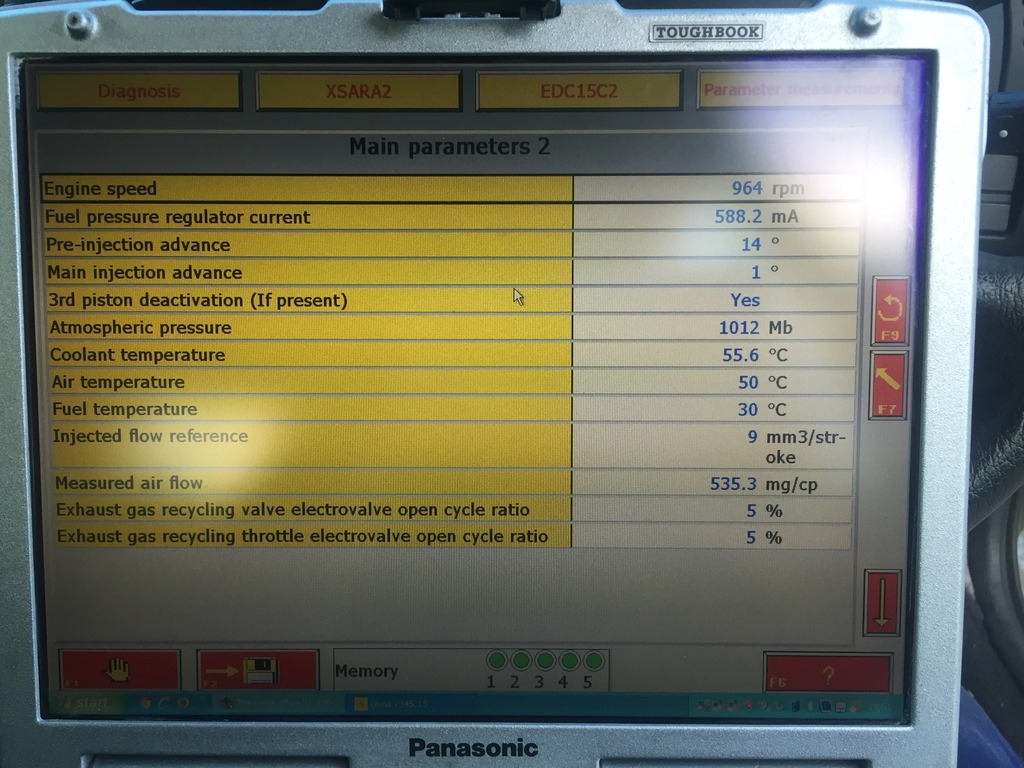

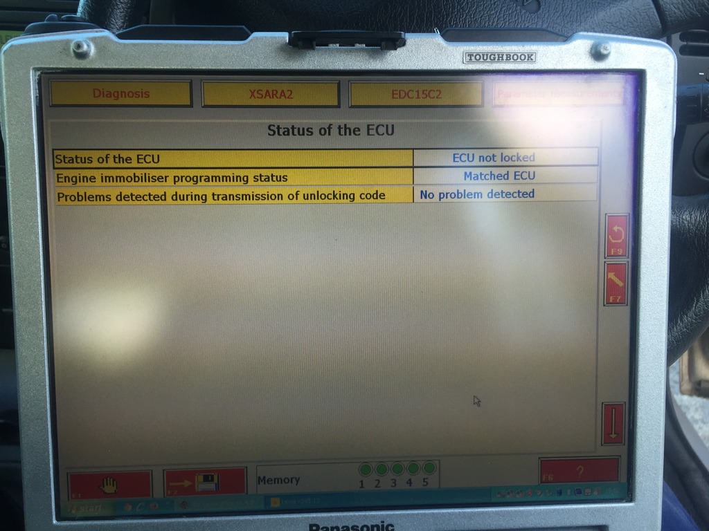

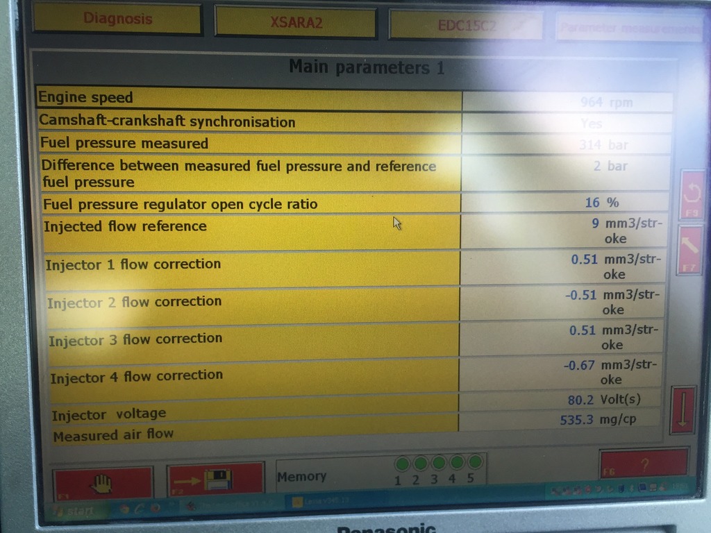

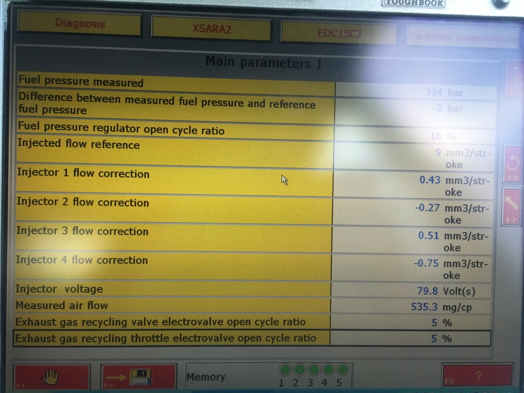

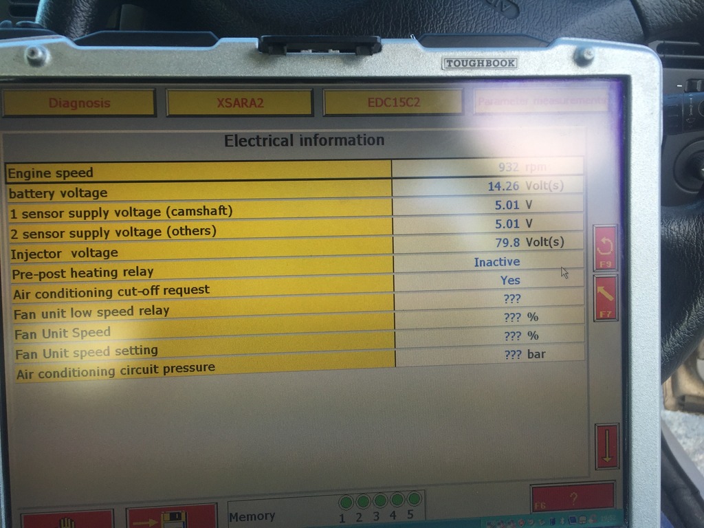

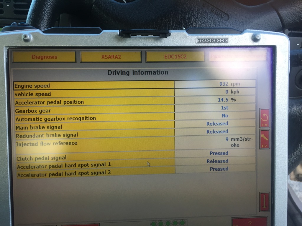

Ill need to check the inner wing tube, i replaced the broken fuel filter housing, poured some redeem into the housing, and the rest in the tank then started it up.
Regarding the MAF sensor, what exactly do they do? For talks sake if the car runs fine in the absence of the MAF sensor why is it needed? I ask as my 406 also has it's MAF sensor disconnected.
Nonetheless Lexia gave the following:
Engine ECU – EDC15C2 fitted to RHY
Permanent Faults
- Inlet air temperature signal. Short circuit to + or open circuit
- Inlet air temperature signal. CAN value not plausible
- Flowmeter signal. Short circuit to earth or open circuit Flow too low
- Pre – post heating relay circuit. Short circuit to earth or open circuit
Temporary Faults
- Fuel pressure regulator. Stop requested but regulator still active
- Fuel high pressure monitoring. Fuel high pressure regulator blocked
Remote Faults
- *Permanent fault Brake switch signal. Communications fault
- Temporary Fault CAN Communications. Fault: BSI communications.
BSI
Intermittent Faults:
- Transponder identifier not received
- Alternator
- Battery Charge
- Brake contact – no press
- Intermittent fault vehicle speed information incorrect value received
- Vehicle longitudinal acceleration information incorrect value received
Here are some parameter measurements:
