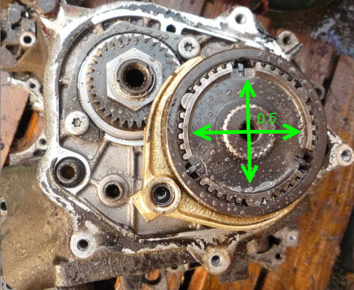

Hello again,
we made a puller and got the selector off.
The only part worn is part "I" in the diagram, which sits between part 11 and "J".
No part number for it though.
Any ideas ?
Any ideas ?

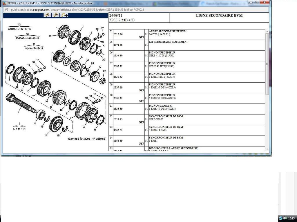

I, J, K, 17, 18 & 19 are part of item 14 (2388 19). Looks like that's the only way to get item I from Citroen. I'm a bit worried by the NFP though. Does this mean no longer available?

Hello again,
NFP is "Ne Fournissons Plus" , so yes , no longer supplied.
Maybe some gearbox specialiists will have the part we require.
An individual part number would have been handy.
Our gearbox terminology is not great - is that part called a "baulk ring" ?

I would call the whole item the synchronising hub assembly and item I the outer sliding ring or collar. It's difficult to be sure from the drawing but item K looks as though it could be a baulk ring.

Hello to all again.
It strikes us that the diagram is incorrect.
Surely part "K" should sit between "I" and "J" , as there is nothing to hold it in place if it is mounted as per the diagram ?
Thanks to all
Thanks to all

I believe the diagram is correct insomuch as it's is an exploded diagram for parts reference only and not an accurate representation of the assembly.
In reality, Items 10 (pinion) and 22 (end nut) sit beyond Item K and 20 and therefore Item K is secured by virtue of the fact it rests against Item 10.. Compare with the other synchros...
Remember 5th gear pinion and synchro are outside the main gearbox casing under the tin cover so those items all sit beyond the bearing retainer Item M...
Hope that clarifies. Generally those parts diagrams are not good guides to the precise assembly of the item in question...

Hello again to all and thank you for the help.
Thank you Jim for the info as we were not aware that the diagram were only for parts reference. Good advice, gratefully received.
However, we are still unsure - its only our ignorance of gearboxes probably.
Item 10 (the cog on the end of the primary drive) is roughly the same thickness as item 11 - and they mesh together.
All other parts on the 5th gear part of the secondary shaft run outside of contact with item 10.
When we laid the parts out, we couldn't see what would keep K from spinning outwards and drop off the end of the secondary shaft. Well , it wouldn't completely drop off as there is a little dowel on the cover that goes into the secondary shaft.
Also, we couldn't see what purpose K would serve in its position in the diagram.
Its probably us just being thick - and also wishing that we had taken some photos on dis-assembly.

Just found this on the French Citroen Forum.
Whaddya reckon ??
