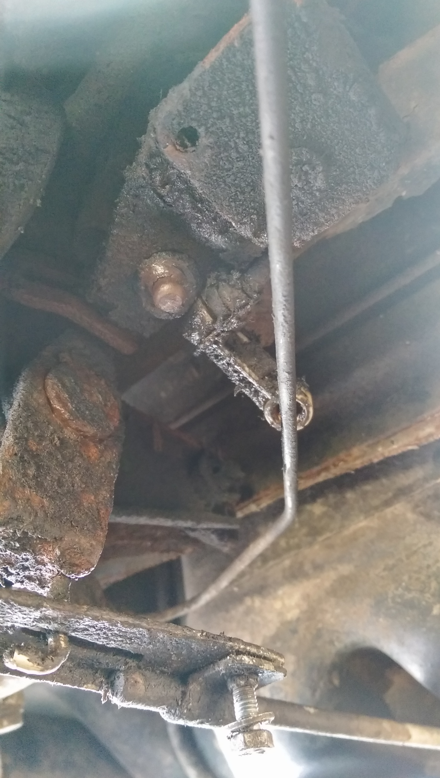

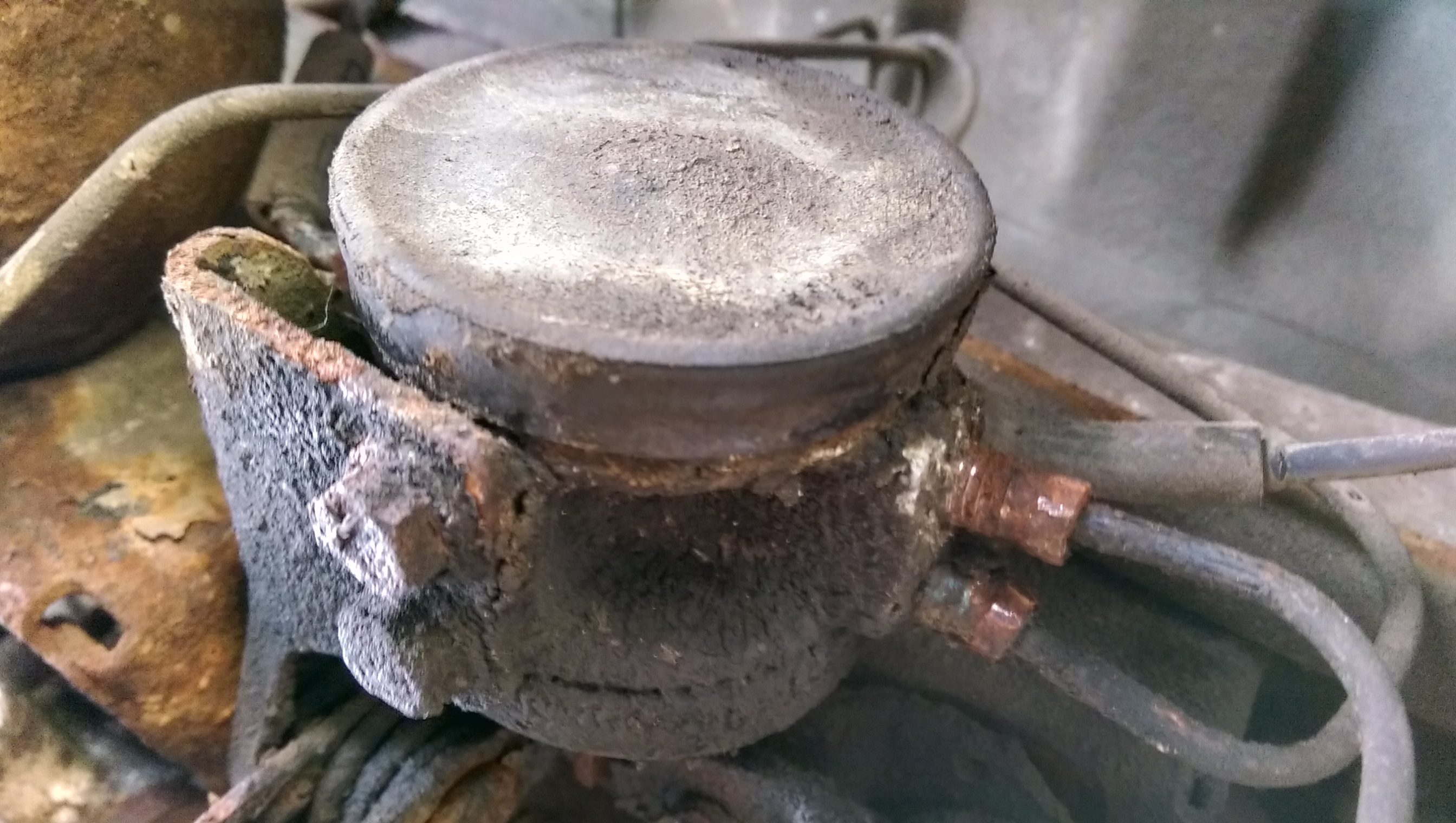

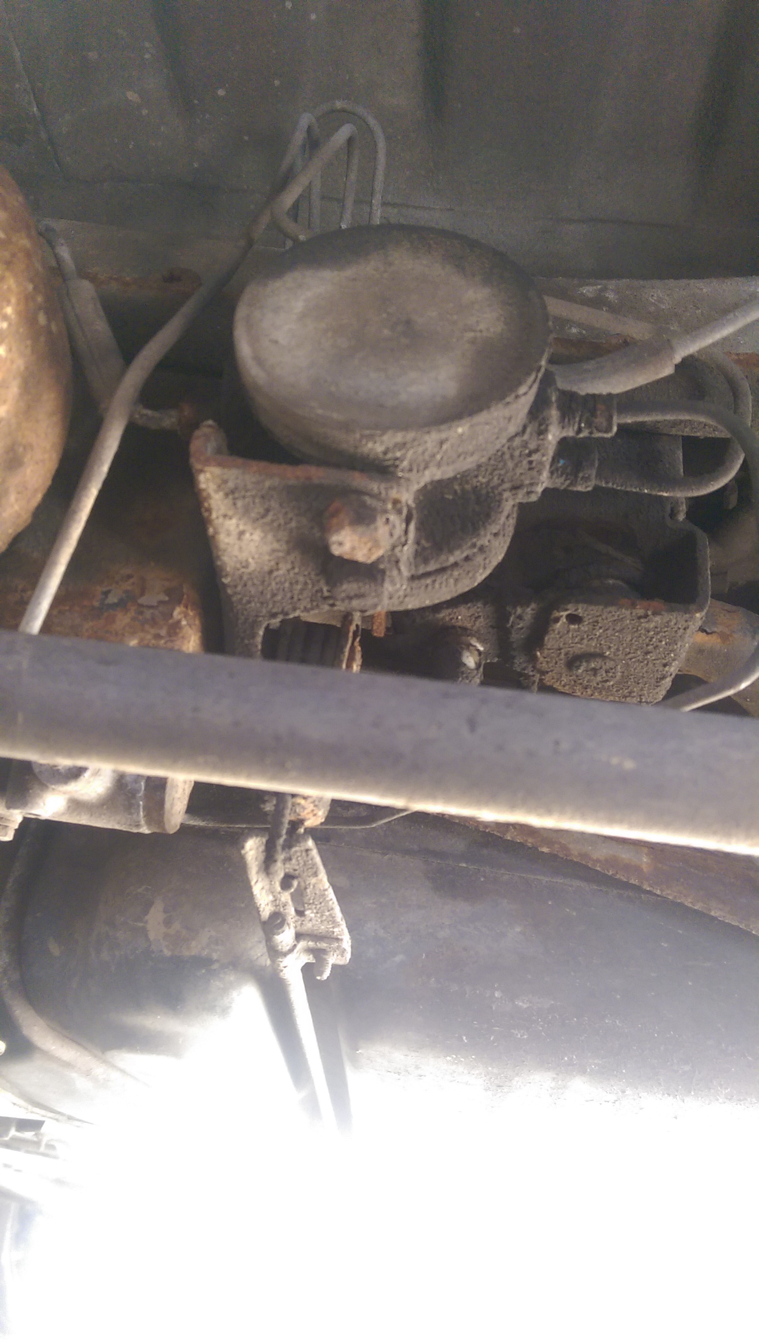

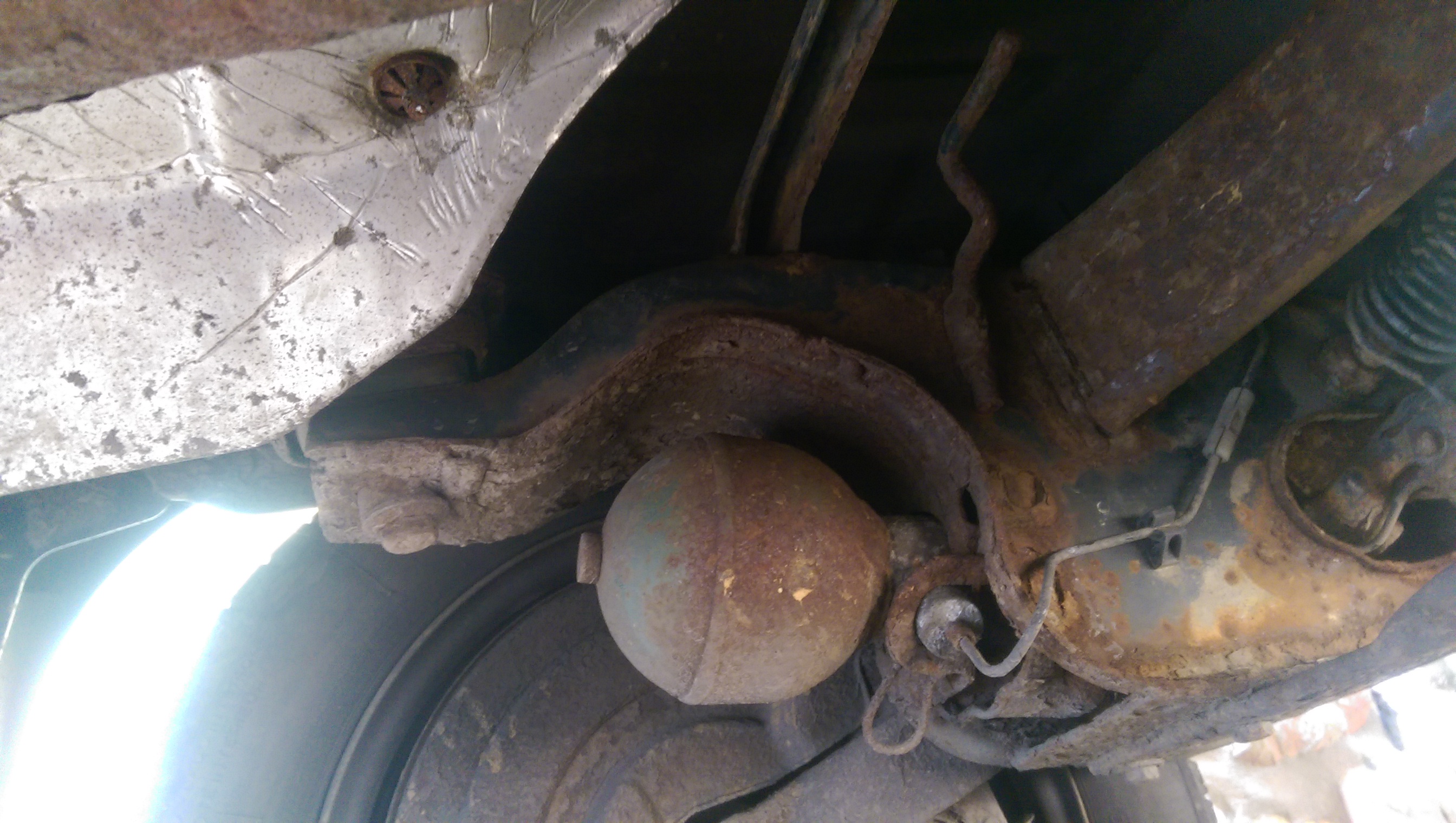

One thing the previous owner had mentioned to me is that the Height correctors were a bit iffy, confirmed to him by a citroen specialist near where he lives a few years ago. I've read the excellent how to guide for removing and overhauling them, and looking at them, I think their due.
This is the rear one
and the front one looks identically smeggy, but I didn't take a photo of that.

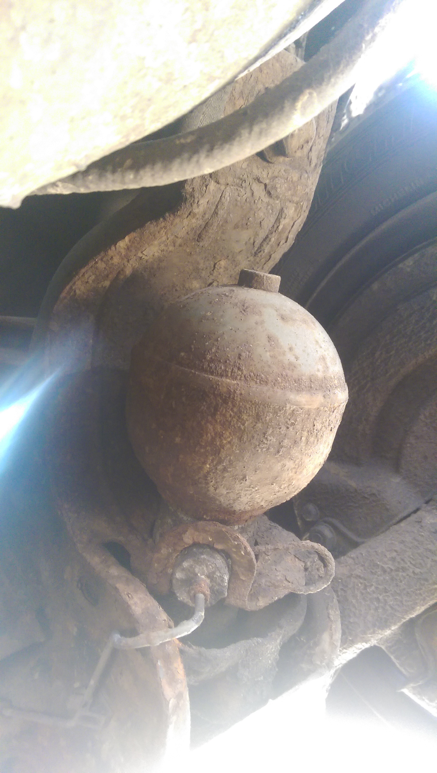

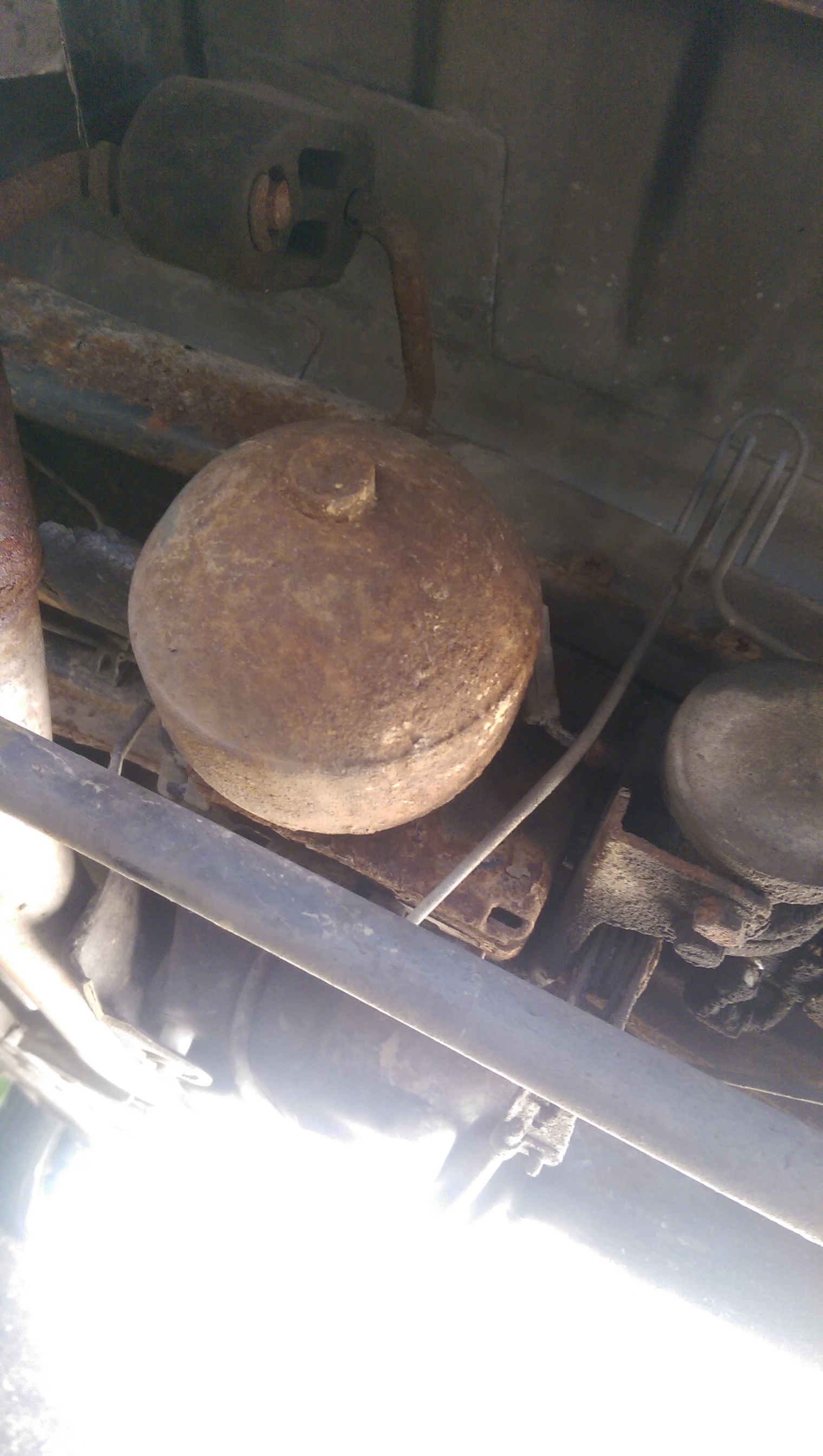

The spheres are also in need of replacement I think. Both of these are the ones on the rear wheels
and this the centre one
I couldn't see the accumulator sphere without the car up on ramps/stands, but I'm going to assume it too is a bit peaky. The car doesn't sink at all, but whilst the ride is generally wafty, it jars over bumps, and shakes the car and steering changing lanes on the mway and hitting the cats eyes. So, I will get them all changed at some point, possibly not very very soon, but it'll be on the list before too long. I need to get hold of a sphere removal tool though, best start looking!

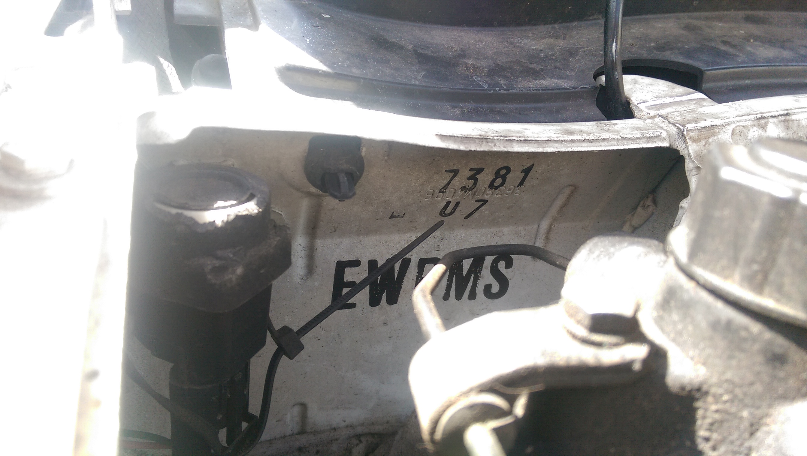

RP Number

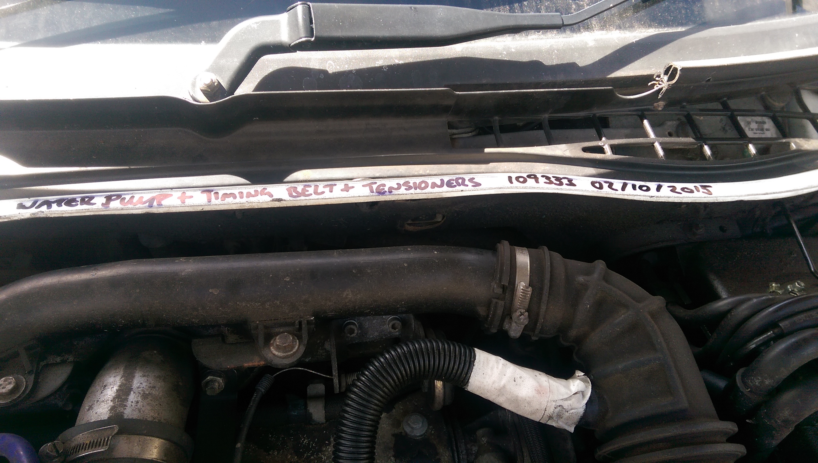

Some service history
and I can check the timing belt as it has no covers on...

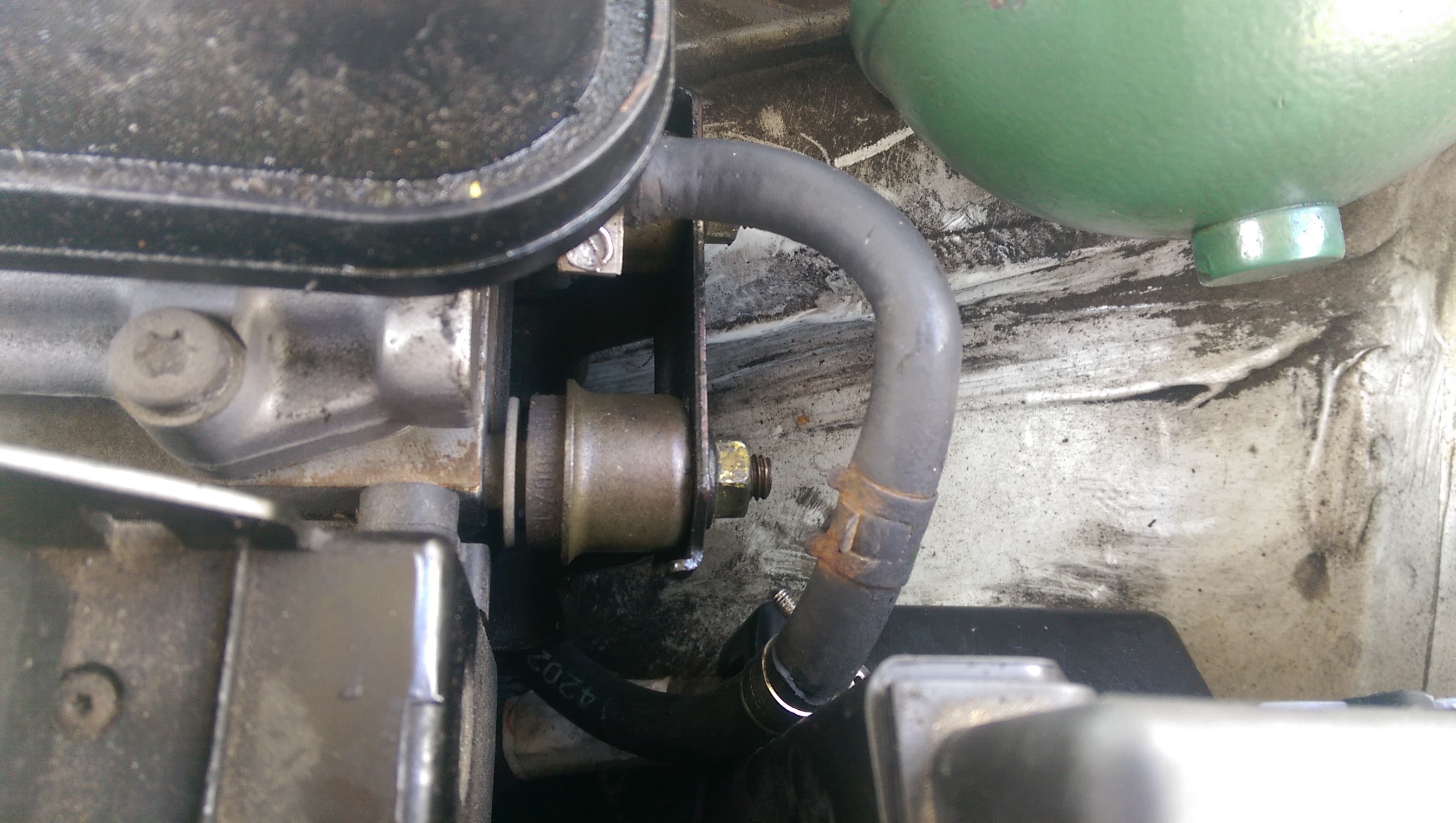

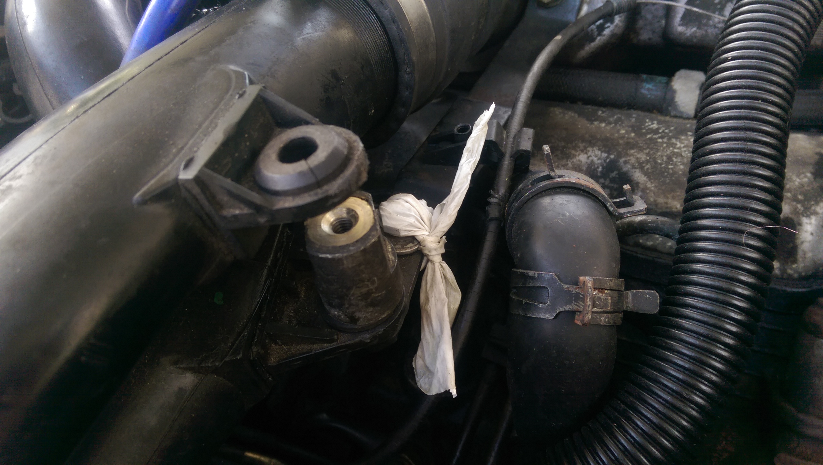

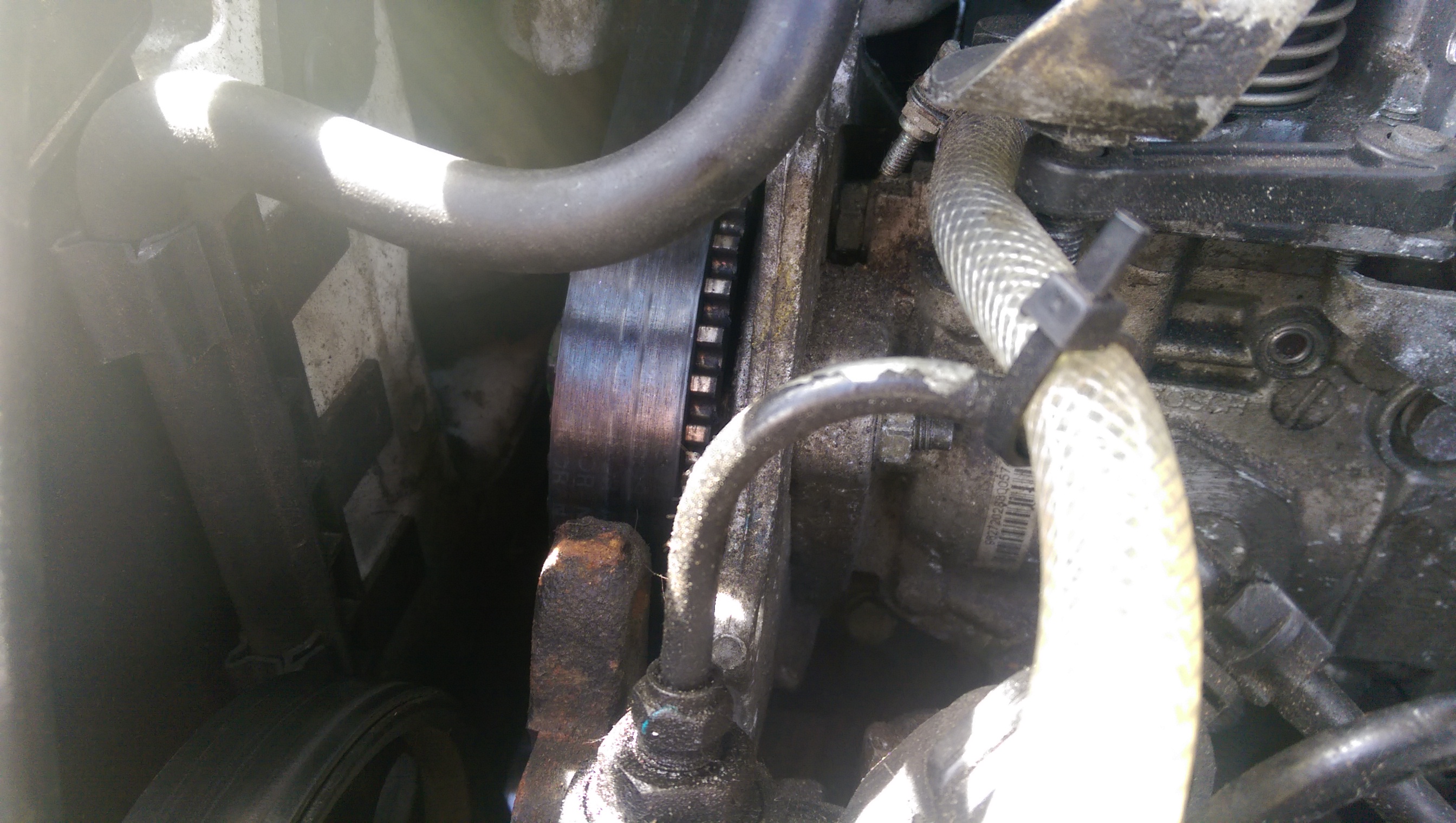

This is the split and temporarily repaired LHM pipe, it comes off the tank and vanishes somewhere
Anyone have a breaker with that hose on that I could purchase? And then provide hints to refit it (where does it go etc)

Corrosion checks aside, that underside is crying out for some wax protection! I wouldn't leave it a moment longer.
And you're right about the spheres probably needing renewal: they look as of they've been 'undisturbed' for a very long time.

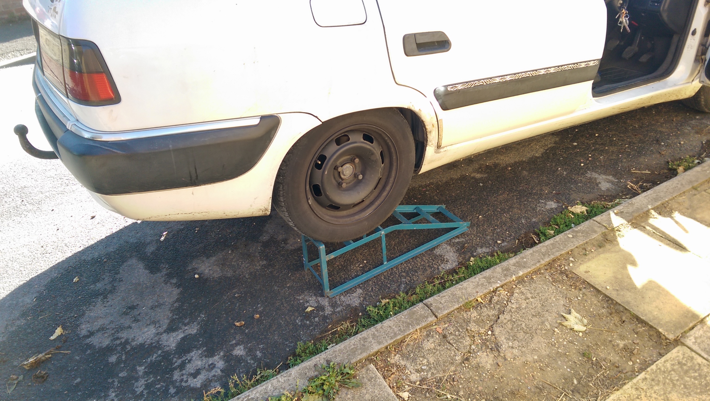

Well this morning was fun!
I popped to the shops last night, and after a few hundred yards noticed that I was pointing upwards in the drivers seat... After checking the seat adjustment I realized the rear of the car was down low. I knocked the lever into intermediate, and the back shot up to the top. a few more yards of bouncing before I could pull over ensued...
Plenty of citrobatics eventually got it riding lever, I had to put her into high, then down to low, then when the rear started to lower put the lever into normal and it caught and stayed. Continued to the shops, back home and put it down to one of those things
Until this morning, when the whole thing carried on! I called work and took the morning off at short notice (helps having a petrolhead boss, much jokes about cheese and baguettes were mentioned), so I got changed, and on the hottest day of the year (so it felt) I got her up on ramps
A quick shufty underneath revealed the plastic dogleg had come off
I must at this point say a big thank you to the Xantia facebook group, being on a tight schedule to get it fixed I opted for facebook for live responses, which worked quite well, and I've learned alot! What I reckon has happened (with my new found knowledge) is:
The rear height corrector seized (several previous owners have said it needed looking at)
The dogleg popped off as it does, hence the odd rear end
So, I had a look. (and made mistake number 1), I removed the bolt holding the height control rod, and removed the rod and bracket.
Everything was seized, but with half a can of brake cleaner, some wd40, the remains of my plusgas (I'm glad that's run out, I dropped it ages ago and liquid shoots out of the nozzle at an angle as well as straight ahead) and some spray grease, got it moving well again. I put the rod back (magnifying mistake number 1 by not checking it's position), got it down from the ramps and checked...still no good
So, back up again, and I thought I would have a look at the height corrector itself (was 10am by this point). I bought a set of cheap flare spanners from ebay, and in true chocolate tradition the first union I tried rounded off slightly.
Some swear words were uttered, and the first rolly smoked... I then decided to leave that the hell alone (can anyone link me to a GOOD spanner for the very stiff and corroded unions?)
I put the dogleg back on...
Someone on facebook then explained to me the importance of the position of the height control rod and it's bracket, so I had another look at it. With the car on, and in normal mode on the lever, I manipulated it up and down until it was ok, then tightened the bolt and went for a quick test drive. Aha! Tools away, quick shower and a fair few citrobatics confirmed that she now rose and fell, and went back to the normal height position. The rear end seems too low now though, as confirmed by me spending the last half an hour reading about the 1 finger rule...
But she drove to work ok, a little bit juddery from the rear end on occasion, although a fair bit more floaty, the rear end sinks and rises now when I get in it...
So, I guess I need to fine tune the height. Someone else on Faceache suggested that I slacken the height adjuster rod off again, then settle the bracket in the middle of the 2 springs, maybe even measure the extreme ends of movement and position it in the middle), then tighten it up based on that. I have not touched the ARB clamp, so won't look at that yet. If properly positioning the height adjuster rod (I vaguely lined it up with the old dirt line) doesn't work, I'll rotate the ARB clamp ever so slightly and see if that makes a difference
Am I likely to break her driving to work and back for the next 2 days? (45 mile round trip) with the back end slightly too low?
Either way, a nice throw into the deep end of rear height adjustment! I really want to get the HC out and stripped down as per CitroJim's guide, but need a better union spanner first (and some more brake cleaner now), and I learned how minute the adjustment is. Laying under the car (below the line of the ramps, just (if I breathed in), barely 4mm of movement sent it up and down.
I forsee a fair bit of on and off the ramps at the weekend as I adjust, off the ramp, citrobatics, let it settle, finger test, back on the ramps, adjust, off the ramps etc, best get some more diesel!
There is also a very small water leak from the engine, it drips down and off the sump, although I can't see where it's coming from (only briefly looked tbh). Will just top it up if need be for now, will look at that another day!

best bet is to get it back on ramps, undo the rod again and push/lift the car until the heights about right, then tighten the rod. seeing as you haven't touched the arb clamp its likely the corrector can't open fully as the manual override is stopping it!
Stu
Cars
1995 Xantia 1.9TD SX in (faded) Red
2003 Fiesta 1.4 Zetec in GREEEEEEEN
2001 206 1.9 LX
2001 Saxo VTR
1999 Saxo 1.1 East coast
1999 Punto :oops:
1996 306 1.8 XN Auto :?
1996 Fiesta 1.3 #-o
beko1987
Posts: 224
Joined: 19 Nov 2012, 13:59
x 16
Re: My New Xantia!
Unread post by beko1987 »
Thats my thinking Stu, its got to be the rod as that's all I touched!
Although 16 miles home, the rear was sitting perfectly. It had sunk a bit over the 5 hours I was at work, but came up ok.
Ive left it in high tonight to see if it's sinking, not ruling out dead spheres, but could do without them tbh, I don't mind the height corrector as all that takes up is my time!
