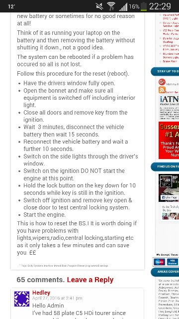

There is a possibility tht a BSI reset might do the trick, bit of a long shot admittedly but easy and free.
Follow the procedure here.
Be sure the battery is fully charged as low voltage seems to cause myriad problems.
Having the battery under the front seat may necessitate a bit of a workaround.

Thank you very much. Will try that tomorrow. Did take the leads off for an hour or so but wouldn't start. .myglaren wrote:Welcome Maak.

What about this?

If you allow for the fact there are a lot of electronics in the modern cars, running a proper shutdown routine can allow it to flush out any glitches. If there is a real problem this almost certainly will not be cleared.
Think of it as shutting down a PC properly. This will allow it to start up from fresh next time you turn it on.
