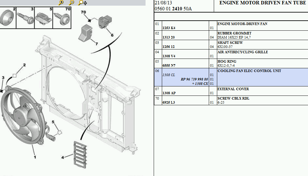

If your radiator fan has stopped working, it will obviously casue an over heating problem - this will be made worse as the air conditioning condenser pumps out considerable heat on top of this. If the fan is not working it can't dissipate the heat from the air conditioning system either and will cause the AC to malfunction. Your first problem may also be realted to the over-heating problem. I would suggest that you try and get the fan looked at as soon as possible - it may be a simple corroded wire - but you don't want to be stuck in traffic with the car overheating for sure. The problem will be exacerbated at idle or slow speeds as you will not be getting cooling of the airflow at speed.

OK - I think this is a 2 speed fan unit - There is also a fuse (F12) at the fuse box by the battery outlet that is linked to the 2 speed cooling fan control unit. - But if the fan is / was working I think your best bet is to get it to the local garage if you can. The next things would be to check the thermostat and water pump. Best of luck - I'll post back a couple of parts diagrams when you get the VIN if you haven't sorted it.

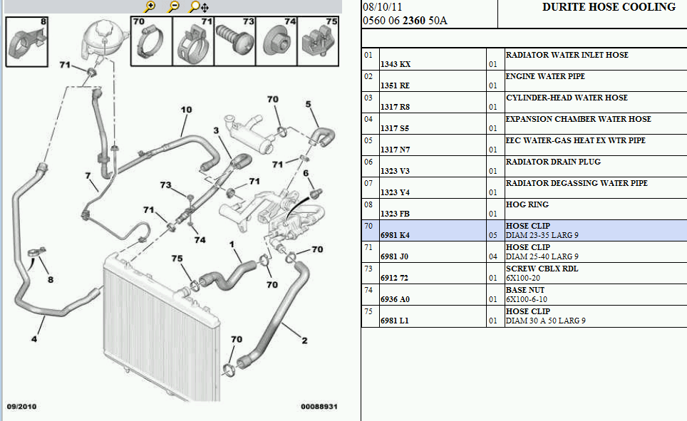

The coolant should be between the min and max levels. I believe the newer coolant Citroen uses is clear in colour - the fact that yours is brown may indicate rust - meaning that the rust inhibitor has broken down - so I would check when this was last refilled. If the system has been topped up with water frequently - then the mixture could be diluted with the extra water and the levels of coolant will be weaker - with less protection. It shouldn't be the direct cause of the over-heating issue though.
I think you could get the garage to check the temperature sensor (top of the radiator - large hose, follow back and the temperature sensor should be visible - but without a VIN I can't be more specific as some engines have a coolant thermostatic valve unit there too. The mechanic should be able to locate it pretty easily though. Your AC should have some thermal protection to shut off if it's not being cooled. I would turn it off from inside the cabin until you get the problem diagnosed - as that will just create extra heat problems.

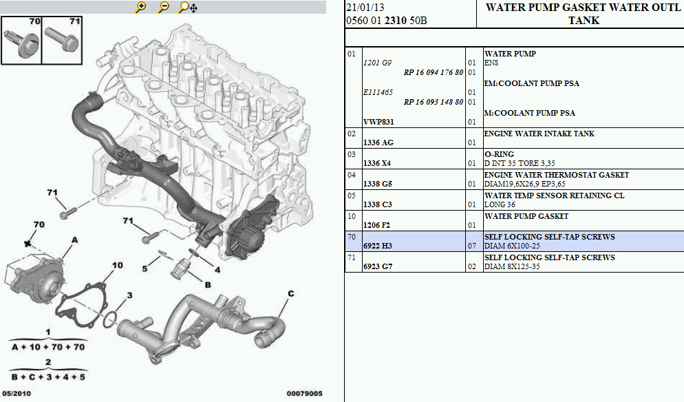

That said, I'd get the temperature sensor checked too. Also another quick check, when you've been driving for a few miles and the engine is up to temperature (but not overheated!) pop the bonnet and check that both top & bottom hose and the radiator itself are equally hot. If theres a significant difference between either hose or the rad itself, it could be the thermostat stuck closed.

Ok - here are some parts of the Radiator Fan, Hoses & Temp sensor location:
Fan and Switches Hoses Temp Sensor I've sent the draining and filling PDFs and the Cooling system details directly to you. The only thing with this temp sensor is that it seems to be part of a kit (part 'B' the sensor is part of the kit '2'!
Anyway - at least you or the mech near the campsite may find these useful along with the other documents for troubleshooting.
