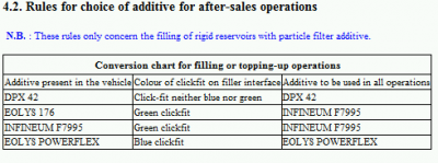

As expected the light has come on - not too bad considering it's done 95k now. Ours is an early one, so appears to be on 176. Later ones use Powerflex - which is cheaper (£127 for the bag vs £170 for the early one). The housing and pump unit is the same part no, and the Eolys thread says 176 and Powerflex are mixable - so, anybody know if it's possible / OK to fit the later (ie cheaper!) pouch to the earlier cars?
- x 6950
Re: C4 Picasso DPF additive
You've probably read this Richard, Additive Mod - which deals with the 'rigid' reservoir and not the soft pouches - but as the table says, if the 176 is aready in the car then use the INFINEUM F7995. I'm wondering why they wouldn't say Infineum F7995 OR Eolys Powerflex if this was ok to do...
They also say to use the products exclusively - I guess it will be down to whether you would want to risk possible filter problems down the line
If it was me, considering you would normally only need to do this 2 or 3 times over the lifetime of the vehicle and the difference in cost being less than a tank of fuel, I would just go with the recommended.

Edit, hold on a mo, misread that table... there is another one, which gives the same information as yours Marc:
So perhaps that is the differnce between the 2 bags, one is F7995 and the other Powerflex. By the looks of it, it doesn't matter if you add either F7995 or powerflex to 176, but you would need to know / note which, so that in future you didn't add the other one and gum it up!
Code: Select all
Additive present in vehicle Colour of clickfit on filler Additive to be used in all operations
DPX 42 Intentionally left blank DPX 42
EOLYS 176 Green clickfit EOLYS 176 - INFINEUM F7995
INFINEUM F7995 Green clickfit INFINEUM F7995
EOLYS POWERFLEX Blue clickfit EOLYS POWERFLEX
- x 6950
It's a real grey area Richard as you can see!
I just go by the service docs (as per the link I gave you which is identical for both the C4 Picasso 1.6 HDi and even the C5 X7) - up to 2013 at least, as this isn't something I would want to get wrong, given that I'm not a biochemical molecular scientist!
