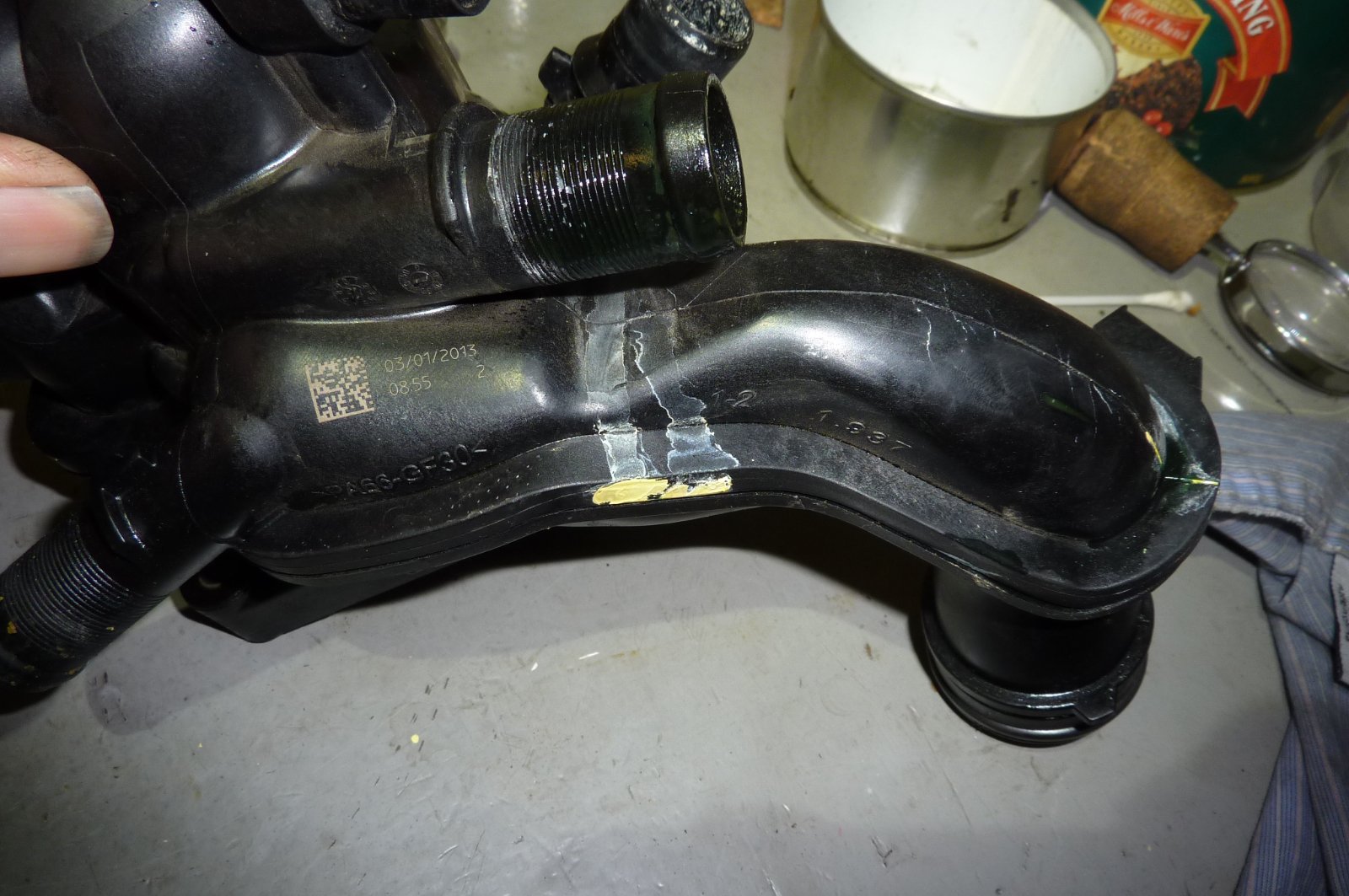

I had a similar experience with erratic temperature gauge readings recently on my 2013 DS5 THP155, and this thread was helpful in directing me to the thermostat bleeder. The readings would sometimes stay low, or disappear. The engine seemed to be fine and if the one sensor is supplying the information to the gauge and the ECM I would have though there would be an error message? I had recently replaced the thermostat after it started leaking (see photo) but I over-tightened the bleed screw on the new cheap replacement and was unsure whether I had a good seal. Last night I put the old bleeder back in and it seemed secure but I will have to go through a proper bleeding sequence again because the readout was still erratic today

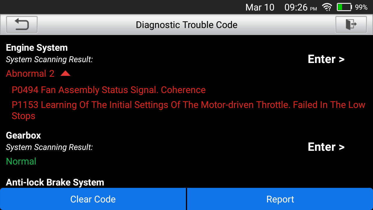

After posting this it occurred to me to scan the car for any faults. This was the result: P0494 and P1153
The engine trouble light is also on now and there was a message to the effect that the engine was unhappy. I will have to sleep on this
