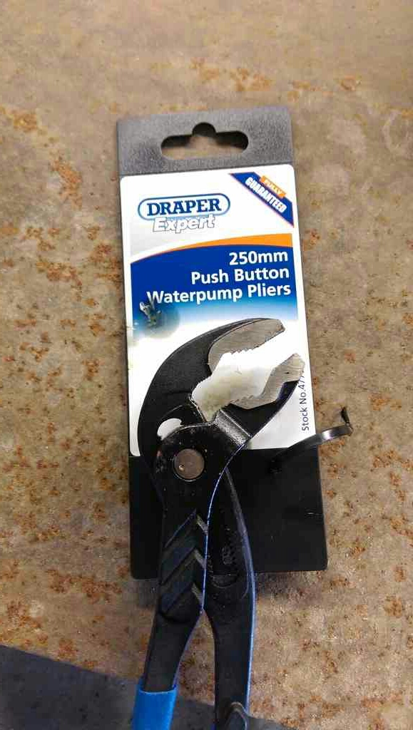

What you need is one of these, which I bought from toolstation;
First side I did at the second attempt, other side I did first attempt. The tool fits perfectly, though I found you do need finger and thumb with gentle pressure on the outside of the hooked ends, to stop them spreading and slipping off.
Second side took a whole 30mins from start (I.e. including strip down) to finish :lol:
It would have been even quicker if the push rod wasn't seized in the trailing arm and it wasn't so filthy inside that it needed a through cleaning.

I thought everybody had those pliers Iain :-D
My favourite is to grind bits out of them,or weld bits on for a "special".

Cheers civvie, know what you mean now... yep, like the original type fitted to the gaitors on lhm Citroen's then.
And nope, didn't have a set of those grips before - I'm more a precision tool kind of guy, as a rule :D however, they were absolutely spot on for that job 8-)
