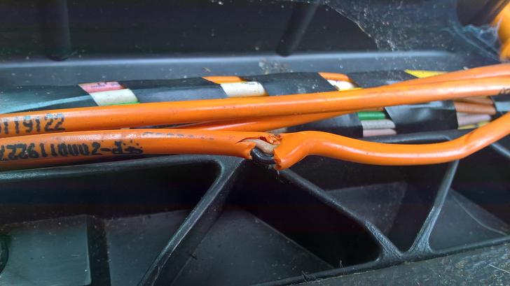

kenbw2
- (Donor 2017)
- Posts: 272
- Joined: 23 Dec 2014, 00:24
- x 24
Re: Synergie/806 Airbag Light on dashboard - how can I diagnose?
Spent a bit of time playing with this. Still got the airbag light solid during ignition, and flashing when running.
- Fuse 12 - the airbag one - was blown, so obviously I replaced that
- I've wiggled the plugs and made sure they're seated
- On the passenger side I found one of the wires was a bit squashed, but it doesn't look broken
It's all a bit rusty and obviously been wet in there, I wonder if that could be a factor.
I'm gonna take a look around the steering column like you suggest.
Is there anything I can do with a multimeter maybe?
