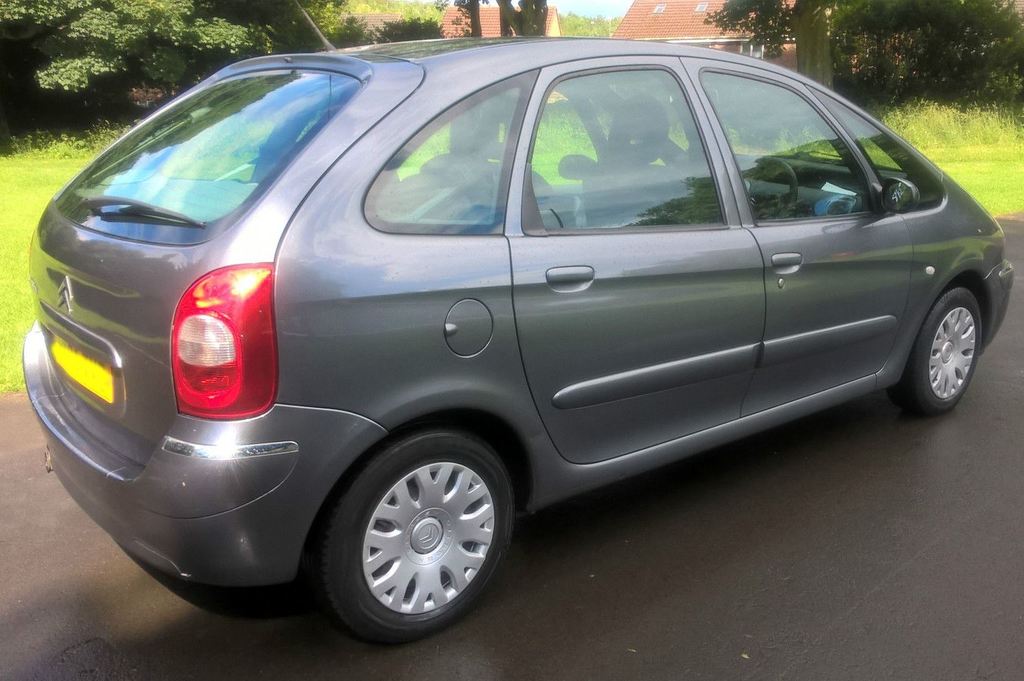

Hello, I suspect these topics have been battered to death but please be kind as I am new...LOL
OK my situation is.
I bought a Picasso the other day ( Monday to be exact )
It started and drove well and no real issues for the price I paid.
Now I own it, I have not had any time what so ever to look at the car as I work weird shifts and need to sleep the hours I do not work.
So last night 16th July I thought I would start the car...well no chance
So I took battery inside and charged it overnight and this morning it said fully charged.
Cut a story short, battery on no power to turn engine fast enough.......
Jumped it off my micra after a while it started............Went to euro and bought a new battery
Starts fine now BUT....Radio goes bleep bleep bleep every few seconds when I switch it on and my central locking works fine with KEY IN DOOR
But does not work as remote key.
Got two keys, one did not start car but after a key programming routine It did.
Did a wait 3 mins after stopped car, removed battery lead, waited and reconnected after sidelights were switched on
Followed that OK but did not work.
Any ideas on a cheap fix lads and lasses as I can not afford to go to dealers. OR is that my only option.
Cheat fixes accepted...LOL
Thanks Steve
Picasso 2.0 HDI made 2004 HELP

Also something not mentioned is the jump starting, which I've been advised is not a good plan with a multiplexed car (one with a BSI). Hopefully a strictly observed BSI reset will cure the "fun" though. Don't know what you paid but it looks a clean motor and I do like that colour in particular.
