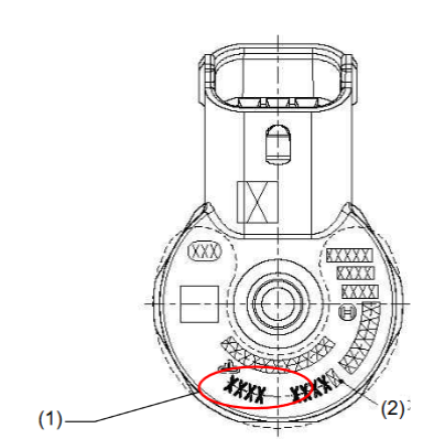

If you have the BOSCH EDC16C3 / EDC16C34 in your 1.4 HDi they will need coding.
INJECTOR CONFIGURATION :
(1) Location of the 8 characters
(2) Location of the ninth character
There are 2 types of injectors :
• 1st generation with 8 characters
• 2nd generation with 9 characters
The diagnostic tool allows you to programme either:
8 characters - Conventional for 1st generation injectors, for 2nd generation injectors the last character (2) does not have to be taken into account.
or:
9 characters - Enter all the characters present on the injector.

x 6945
Re: Lack of power after changed injector
It may not cause the severity of the issue described, but will not perform as it should due to the injector tolerances. The injector IMA code allows the ECU to adjust fuelling to the injector's specs. Even re-manufactured injectors are supposed to be supplied with a new calibration code.

Started the car this morning and it started without hesitation which is good ! Still have the issue with power if I Rev in neutral it revs to 1500rpm no probs but struggles past that but when driving it struggles upto 2000rpm and then is fine after that. I noticed when I press the accelerator there is a clicking noise like a relay noise that sounds like it comes in and then off again when I press the pedal ?
Thanks givemeabreak I will check the turbo pipe later after work. I also looked at the info you gave a link to for injector coding and I will also take a look at that later I guess it's in configuration then ? I did look in there but couldn't find anything but maybe I overlooked it. Would the option not appear in lexia if if was not needed ? If the Siemens injectors don't require coding ? Also I have all the info off the new injector on photos they are a bit different to the Bosch ones in the image you posted.
