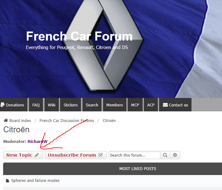

Re: Help! Citroen c4 2.0hdi 136hdi, lack of power.
Just click on the French Car Forum banner at the top of any page.
Select from the available Forums which one is most suitable to post your Query in (I'm guessing 'CITROEN' in your case)
So in this case, click CITROEN
From the Citroen Forum at the top you will see the 'New Topic' button to create a new thread:
