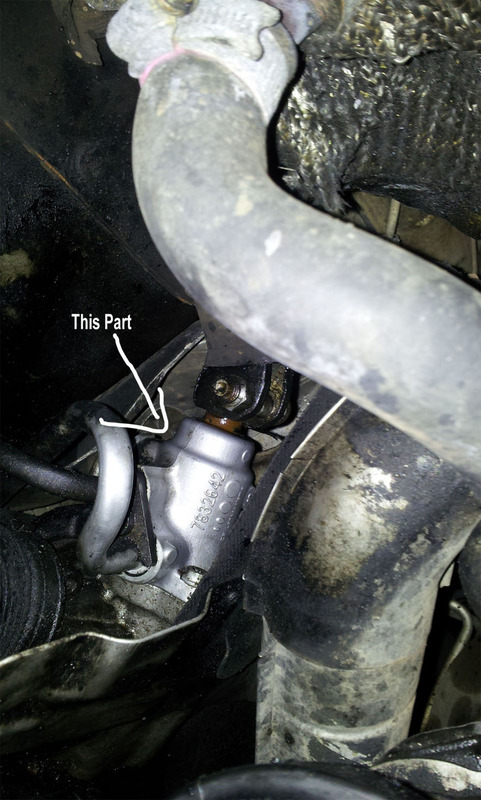

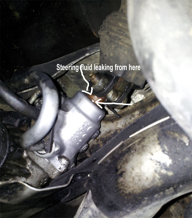

Can anyone please tell me what this part is called that is attached to my steering rack? and can it be bought separate from the rack? The problem i have is the steerig fluid is leaking out at the top of this part
Vehicle is an 07 (mk2) Peugeot expert van 2.0 hdi

Its counted as part of the rack as far as I can see so no spares are readily available , at least from what I can see. The other listings show the pipework / pump and the column etc. I see nothing else that lists the rack specifics unfortunately.

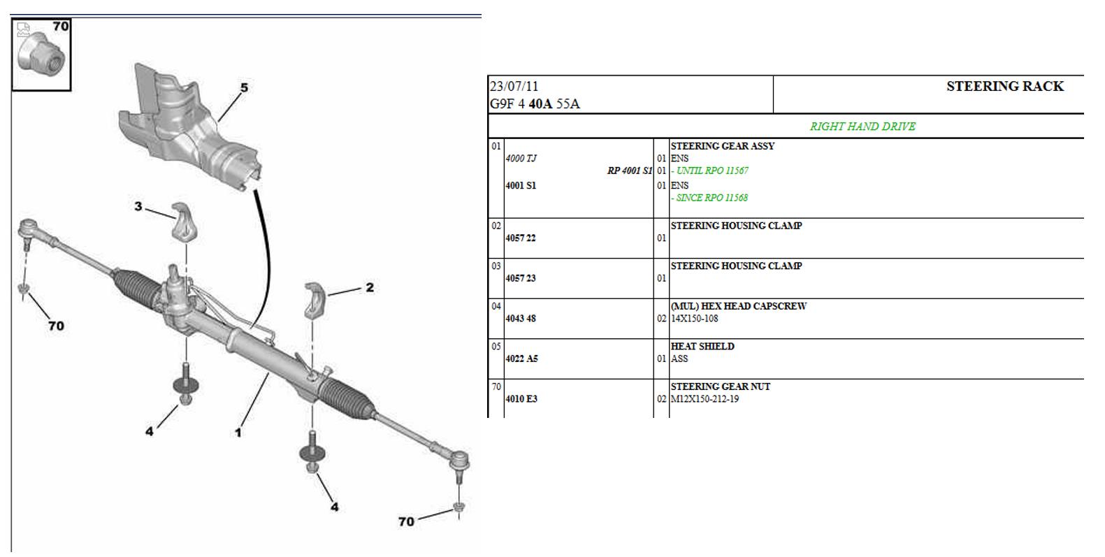

Having said that a bearing or hydraulics place would be able to supply a suitable seal. You (may) have to remove the rack for decent access. Here's a pic of what the dealer lists:
Andy.

I believe it's called a pinion seal, and as spider mentioned it's likely to be a case of getting a suitable seal from a hydraulics or bearing factors.
Having said that wouldn't you agree, spider, that the pinion valve assembly itself looks fairly recent (as in been replaced separately) compared to the rest of the gubbins under there?
Not familiar with the buildup of this but from the look of it in the photo I'd suggest the pinion valve ass'y could be removed from the rack separately (and fairly easily depending on tool access). If that's the case it'd be a lot easier to just take that off to get the size of the seal. I'd have to ask myself though, if it's been replaced recently and is leaking again, why is this.
Could there be a problem elsewhere in the system causing the new/recon item to fail (unlikely I'd have thought, more likely to suffer low pressure not high!) or is it more likely it was either a cheap repro or recon part/damaged during fitting?

I did notice it looked 'clean' :) But I was not sure if it had been cleaned up prior to the pic (aersol can of brake cleaner etc) to determine where the leak is coming from. Having looked again, its a different shade so I suspect it may well of been replaced. I do not think access 'in situ' is good as there's a bolt or two at the back, not to mention possibly a shim or three or a spring under there I think. I do not think I've taken a rack apart actually.
If it was replaced then as you know the only likely cause of it to be damaged is the shaft itself is rough and 'tearing' (for want of a better word) the new seal ? Does that make sense ? :)
I don't think too higher a pressure would just blow that seal though, I'd expect the ram seal to also suffer as its subject to higher pressure there, unless there is some quirky internal fault in the rack itself.
If this was mine, I take the rack out and carefully remove the seal (couple of self tapping screws etc or suchlike or a seal 'hook' tool if possible) then take said seal and rack somewhere to obtain a seal, this way hopefully they'll measure it too, or measure with internal and external calliper to determine what is needed.
Having said that I bet some places will know exactly what seal is needed so there may not be a need to go this far as such.
A decent garage may be able to obtain and replace this seal however if you wanted a "clean hands" operation. Some may baulk at the idea of not fitting a complete rack but an 'old school' garage should have people who know what do to. Its actually very easy, the *problem* here is access, cleanliness and obtaining the correct seal itself.

Thank you very much Spider and ekjdm14 for taking the time to reply and give so much detail on the issue i'm having i really appreciate it :) It looks clean as i have been cleaning it a few times a day for the last couple of days to confirm where i was loosing fluid. It does look like it is going to be a pain to remove but i guess it needs to be done. The main question is would it be better to fit a seal if one can be obtained or would it be better to fit a refurb rack seeing as the current rack is going to have to be removed to fix the seal?
