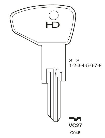

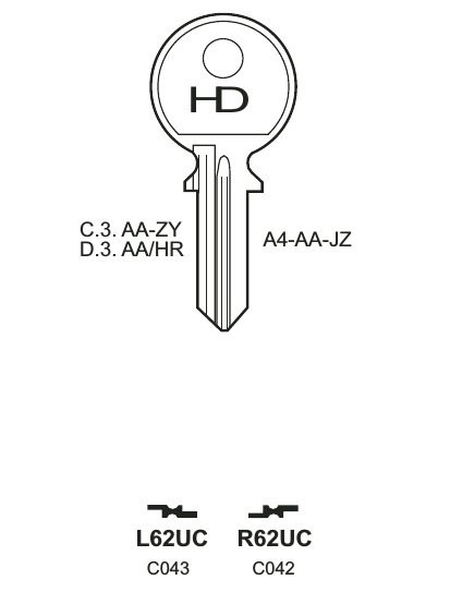

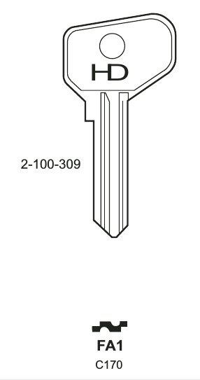

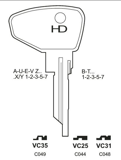

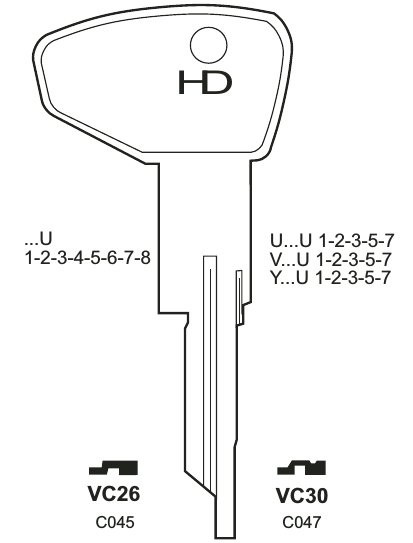

I had no trouble getting a locksmith that had blanks on the pegs, but that was a good few years ago.sonoramicommando wrote:had a look for blanks on ebay and chevronics and the other german vendor but nothing is showing up (other than key/lock combo at stiff price)Stonehopper wrote:This modern stuff . . I dunno!
Best try the corner shop key cutters. Blanks might be a problem. Mine came with a new blank in addition, so only had the corner shop do his stuff.
On my 1978 car, the ignition key is Simplex, the door key Ronis and petrol cap key Faab.
Davenport Burgess lists the blanks as VC31, L62UC, FA1. Beware the the door key also has reverse cross-section cousin and that the ignition might also take a VC30 which is almost the same in cross-section to the VC30.

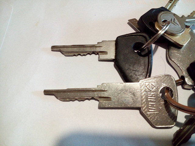

Having found one of my spare sets, the Silca blank numbers are SX3, RO10 & FAB2. The SX3 is 12mm longer than the SX4, but the business bit is the same length.

Re: cutting spare keys
Those images aren't to scale, the FA1 is about the same size as the door key.Stonehopper wrote:Of those key profiles my GS looks like the FA1 (ignition that is).

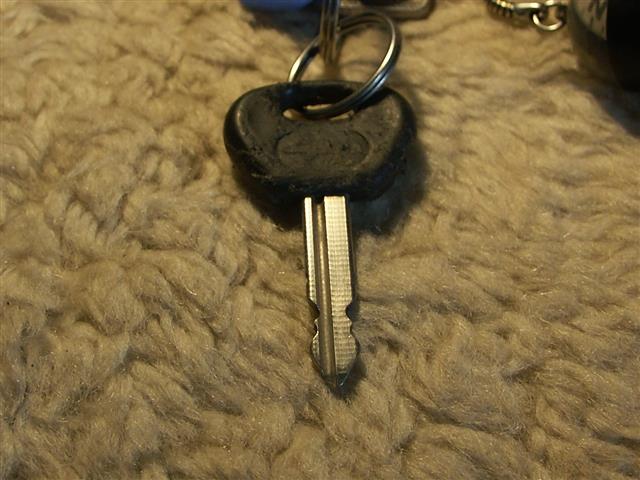

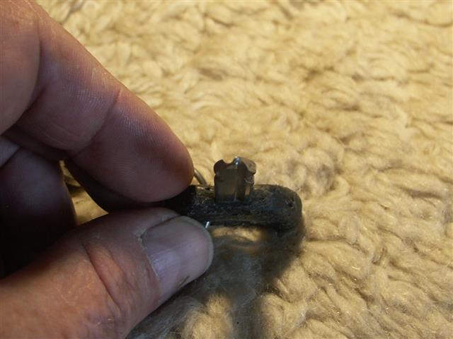

Yes, and looking at my key the end on profile is none of the above. 8mm wide and 35mm long. Silca on the rubberised head.

I could only find 3 types, early GS, later GS and GSA. Does it having a Simplex key switch? Or maybe it has a Niemann?
(Note for anyone wondering: cross-section in catalogue is for blade being pushed into the screen, rather than looking a key with the tip facing your eyes.)
