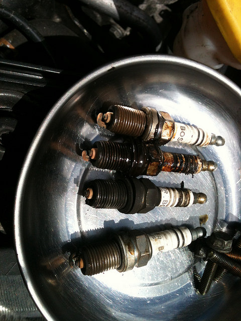

So far as i see the running issue was a very, very loose spark plug, that nice Tan deposit you get on a plug was coating the whole plug wel tool and the coil was burnt, this had also happened to the loose plug which im guessing was the problem and would explain his complaint about the smell of burning in the cabin and petrol smell for a month or two before being forced to take it off the road, im just hoping the cat isnt toast.
Imagephoto(23) by Deanxm, on Flickr
I think this slight lack of ground electrode and an incinerated coil would account for the missfire and emissions fault code.
Im going to drive it tomorrow to its MOT so i will find out if it really is fixed and i will ask the tester if he has any ideas about the missing history.
