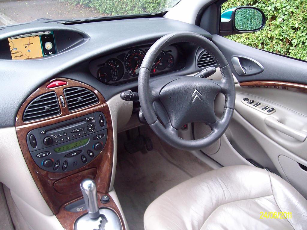

My C5's VIN is VF7**************[VIN obfuscated, can be read by forum staff], although im not sure if its an SE anymore from the ABS pump thread.
This is the interior of my C5 (a few years before i got it when it was cleaner)
Im more interested to know what options were available at the time on the C5 above what mine got, purely nerding out on 2001 specs, this headunit looks quite interesting:

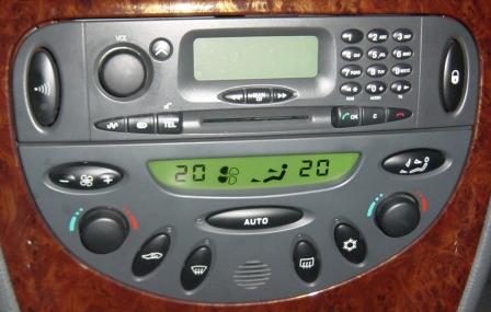

If I understand you correctly - the top picture is your C5 and the bottom one is another head unit you have seen.
For your car, there were 3 categories:
The bottom one is the RT2 unit.
All three have in common the radio / music display showing on the multifunction display, the audio commands integrated into the steering wheel & compatibility with a CD Changer.
The RT2 radio also has an integrated display for displaying the radiotelephone function. Note: Citroen say you cannot fit an aftermarket CD Changer - the only one compatible is the 6 Discc changer supplied by them.
- RB2 Radio Receiver with mechanical cassette player
- RD2 Radio Receiver with Compact Disc Player
- RT2 Radio Reciever with GSM Telephone

RT2 then sounds like the job, get a good full sized sim in and drive about in a mobile phone haha.
