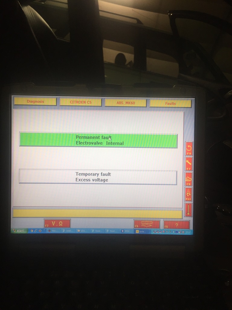

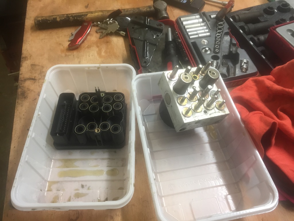

The only failure point at the MOT was an ABS light, It has a problem with the ABS block, according to the lexia tool. Took it out to realise that there is not much in there that can be worked on:
I need some advice about getting a replacement pump, will any MK1 C5 ABS pump do, say out of a HDi? Or must it have come from a V6?

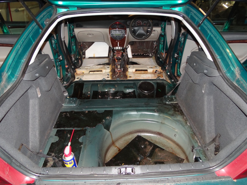

Some cleaning of the interior:

That is some extreme interior cleaning lol.
Nice to see some mk1 C5 's getting some good attention.

PC2CV wrote: The only failure point at the MOT was an ABS light, It has a problem with the ABS block, according to the lexia tool. Took it out to realise that there is not much in there that can be worked on:
What was the fault code precisely ? What you have taken apart is the hydraulic block for the ABS, but unless the fault code explicitly suggests the hydraulic block is faulty I would have my doubts that it would be the problem.
The vast majority of ABS faults are electrical in nature, typically either wheel sensors or wiring. ECU failures are rare and I've actually never heard of anyone having to repair the hydraulic block itself...
If you have a Lexia finding the problem is going to be much easier. Aside from fault codes, you are able to test the wheel sensor speeds (jack the car up and spin the wheels and watch the reading on the Lexia) and also test the actuation of the hydraulic block - you do this by holding down the brake pedal firmly with something like a length of wood wedged against the seat then tell the Lexia to test a particular wheel - you then try spinning the wheel by hand with it raised off the ground and you'll find that during the test the wheel locks and unlocks repeatedly under computer control even though the brake pedal is held down.
This is an indication that the hydraulic actuator for that wheel is working as it should. The electrovalve controlled valves in the block turn off the brake on that wheel when energised, as their default mechanical position is of course for the brake to be enabled for safety reasons and the ECU will only disable the brake on an individual wheel under very specific and carefully controlled circumstances.

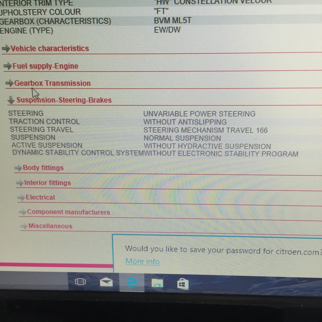

Im a bit confused if it has ESP its an Exclusive SE has everything else, dont seem to see any ESP off button, ive got a sport mode and winter mode button by the gear lever.
Servicebox says this, still not certain if it has it or not? "DYNAMIC STABILITY CONTROL SYSTEM WITHOUT ELECTRONIC STABILITY PROGRAM" is a bit confusing
This is what Lexia says:
I was told that if one of these sits up for a length of time the valves can stick.

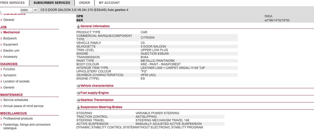

Interesting.. I assume your in the uk.. However i could be wrong but possibly when new there was a choice to not choose esp when ordering..
The car could be an exclusive but not an exclusive se which in mk.1 c5 were two seperate trim levels.. However next to your vin number on lexia screen where your car is described if it was an exclusive it would say there which it doesnt. Trim level upper low plus.. Indicates its not top spec. Interesting spec level..

There appears to be about 5 different ones - even if it's not got ESP it might have traction control, so you need to get the right one - actually looking at yours, it does have TC - so you will need to find one off a car that has TC but not ESP!

This came from a HDi 110 that a local breakers had in stock, they were good enough to let me check the vin on their computer:
It has the same dynamic stability control without electronic stabiltiy program, but no antislipping
