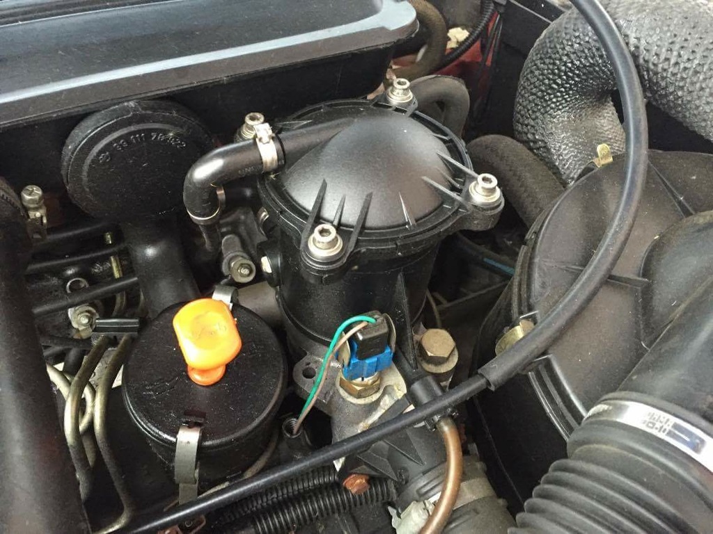

Here is a photo of my temp sensor
Looks like there are two spaces. One appears to be plugged and the other is the switch? I'll have to run connectors/wiring ( #-o ) or could I just do away with the switch entirely and replace with the sensor?
The final question would be whether the pinout cluster side is the same (probably unlikely if they use two separate sensors for warning and gauge). Is it easy to pin swap on these connectors? I have only done this on BMW's and JLR cars which both use Tyco connectors.
If anyone has a picture of their temp sensor setup on a ZX (with temp gauge and warning light) then I can look to replicate the OEM look.

Re: Temperature Gauge Citroen ZX
You will need to acquire an instrument cluster from a similar ZX, which has the instruments you require.
At the same time, if doing this in a breaker's yard, try to get hold of the temperature sender from the same vehicle, or, if this isn't possible, try to find the exact model, year, engine, etc. of the vehicle the new dash panel came from. Better still, get the vehicle's VIN number, and from that we tell everything there is to know about the car. The reason for is is that the temp gauge and sender need to be of the right type to work together. Guesswork might be good enough, but a "correct pair" is a safer bet.
You might as well retain your existing temp warning switch, and use the blanked off location (bolthead in photo) for the temp sensor for your new coolant temp gauge.
If you have two fans, they are controlled by a 3-pin "thermoswitch" (usually mounted in the radiator side). This switch closes in two stages, at a high temp and then a higher one. At high temp, the fans are switched on in series (and run at slow speed); at the upper temperature, the fans are switched into parallel (and both run at full speed). This switching is done with a cluster of three relays, working together.
