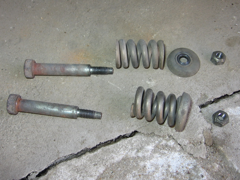

Could be exhaust springs, bolts & o rings apparently common on 1.6 petrol according to C4Owners

I have got hold of the replacement fixing screws and gasket etc and will fit these and see if that solves the noise. I must admit I am a little sceptical as the noise appears to come more from the suspension, but I have already tried all the obvious suspects to no avail.
I shall report back with results in due course if a solution is found.
