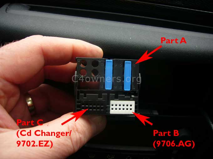

I have taken the radio out and I see that the two big connections are not plugged in to the radio. They have like blue "caps" in them ! All the other ones can be plugged in. I am wondering if they have had an after market radio fitted and just plonked this one back in.

This?billyg55 wrote:They have like blue "caps" in them !

It's quite possible they put an aftermarket unit and put the original Head Unit back in afterwards - your Head Unit is also the interface that can turn on and off some vehicle functions (i.e. rear wipe in reverse gear, guide me home lighting, etc.) as well as set the date, time and other audio funtions etc. Can you post or PM your VIN so we can see what audio unit was originally fitted. I suspect you will still need to get a Lexia on the vehicle to check what is happening in more detail, but a good start is getting the block connector put back on for sure.

at £90 I think I will just sing to myself !!! I have just sent a pm to a lad in st Helens asking to have a look for me. btw what are the blue plugs on the radio terminal blocks for ? thanks

The blue bolts prevent the connectors from falling out ... you can pull them out easily, but unless you write down the color coding beforehand, don't do it
