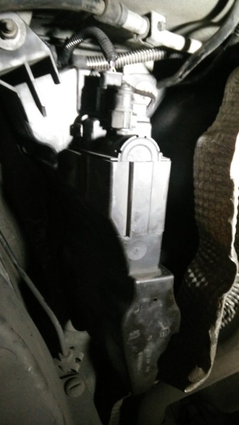

Hi, I have here a C3 HDI 2011 1.6 and it needs refill of eolys
Where is this tank and how to refill?

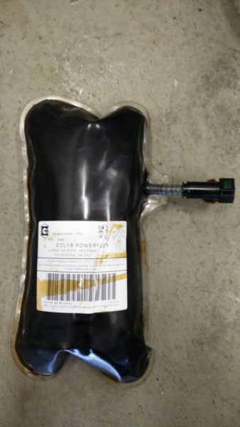

Post up the VIN and I'll look them up. 2011 was the change over from 16V to 8V engine - belt change on the 16V is reasonably straightforward, I would imagine the 8V is similar - do you know which it is? 16V has a plastic engine cover saying HDI 16 on it, 8V just has a felt cover. Eolys tank is probably a flexi pouch - you just change the whole thing.

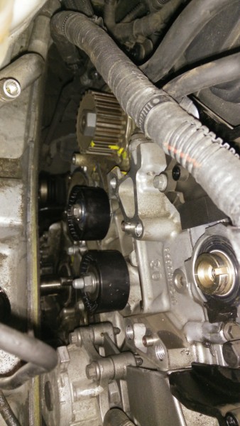

well its getting there but, the injection pump has no blocking hole so marked it.
injection pump and camshaft pulley timing every time off when I install it any tips?

Re: C3 HDI timing belt and eolys
Have you got the crank pinned in the proper position and not using the one above the exhaust which is only for undoing the crank bolt?
I didn't have much trouble on my C4 (this is the older 16V engine, but the belt set up looks the same) - although I couldn't get the belt back on with the idler pulley in place - I had to fit the belt first, and the pulley after. Have you got the tension OK - IIRC it was quite difficult to hold the tensioner in the correct position and get the nut done up.
I did check the Eoyls, and yes, it's a flexi pouch on yours.

yes did refill eolys with 3L can and belt is on.

I did reset with my Delphi DS150E luckily it has those options. Its on 230.000km So the next 240.000km[150k mls] here it goes
I refilled the pouch with a 3L powerflex can as this is cheaper than the pouch. It also had a full service so ok for the next 16k mls.
I removed the whole Eolys box to refill it.
