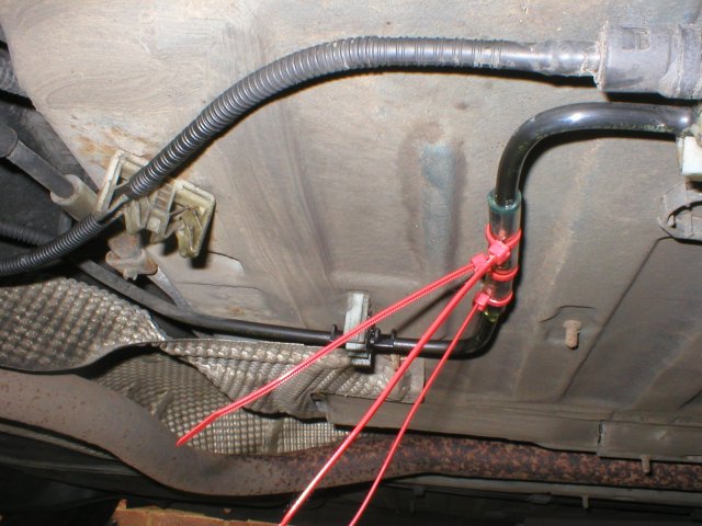

Here's a picture of the pipe that's gone:
It loops up to the top of the tank under the floor and the other end connects to a connector just almost out of shot to the right of the picture...
I'm presuming the other end connects to the fuel pump and if so, I'm shocked that access to the pump (presumably in-tank) is not easy at first glance...
If it's a tank drop job then my local garage can do it...

Bizarre place to go - a stone flicked up off the road perhaps?
Will have a look at the diags when I get home. Poss equivalent to C3; I'll have a look on the cit doc back up for any info on changing it.

Item 4 by the looks of it?
Reference Description Quantity Price - VAT Price + VAT Total + VAT Selection
00001507C7 FUEL FEED PIPE 1 21.04 GBP 25.25 GBP 25.25 GBP
It does appear to show a blanking plug above the fuel pump - its on the NS by the looks of it.
C3 procedure says to remove the seat base (3 bolts at the back somewhere then tilt up) which then exposes the blanking plug.
